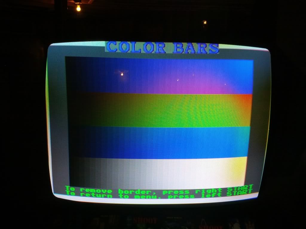

Thanks again for everyone's help with my previous yoke questions...
I installed the monitor in my Max Force / Area 51 combo last night.
When I powered everything up, had some rainbow colors around the edges of the screen. Figuring it was a degauss issue I looked around the chassis and realized the degauss wires were just hanging from the monitor (not hooked up)
I powered down, hooked up the degauss wires and powered back up, but no difference...
What would you do to correct? Think a degaussing wand would correct? Anything else I can try? Will time eventually fix it?
Here is how it looks after being powered up for 5 minutes:
I bought a degaussing coil this year to fix a prob that looked just like that. Worked great for me.
Why is the red showing up as blue? That would be one heck of a gauss issue.
If you let the monitor power down, and cool off, the degauss will kick in the next time it powers on. You already had it up and running, so it didn't have the opportunity to cool off.
I don't get it either... During game play, its only noticible on the top 25% of the screen... Which its why I am thinking its degauss....
As for power down and cool off.... haven't tried it again since I shut it off... Will try that tonight.

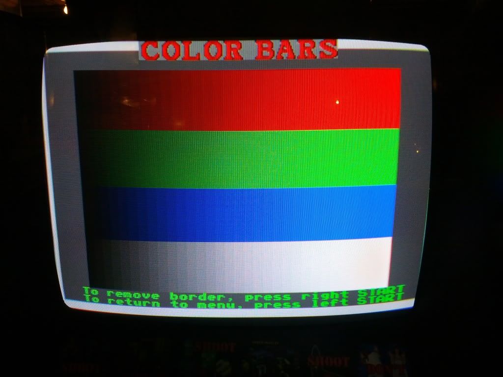

This seems to have rectified the color issue! Powered it on today and everything was fine!
Here it is tonight:
