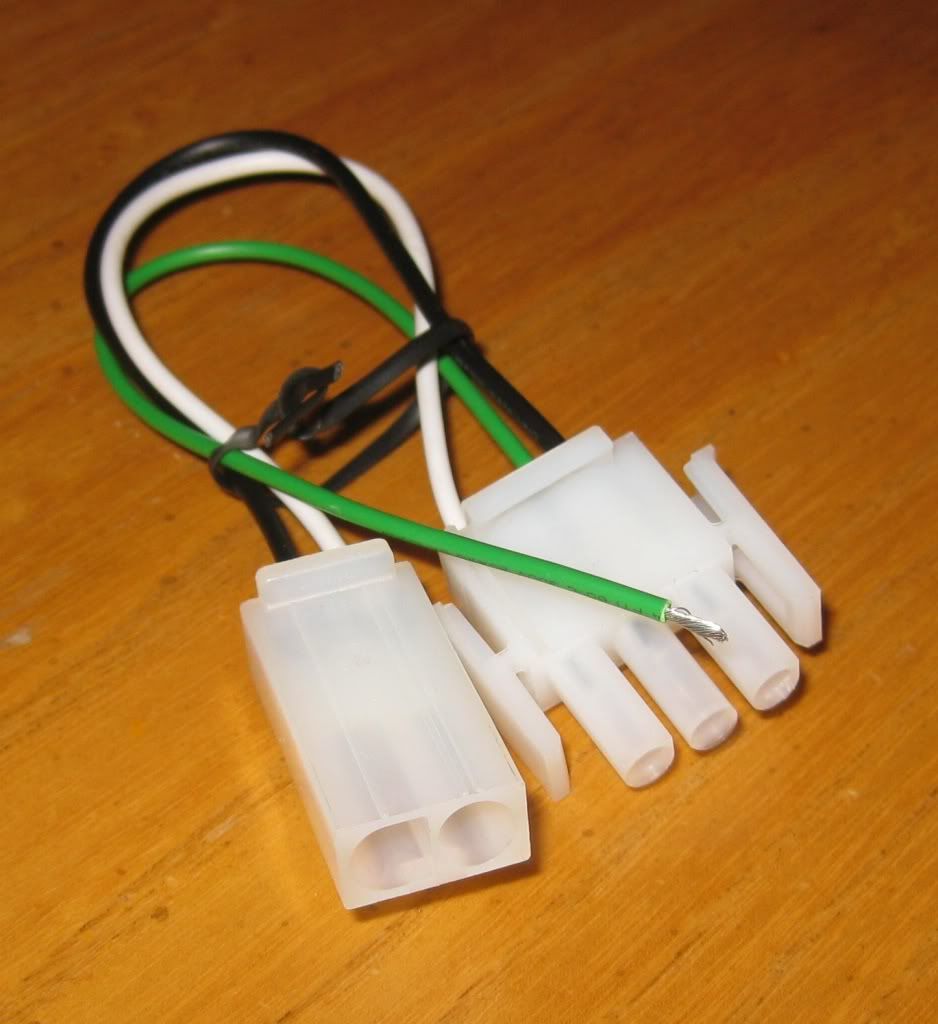

Yeah, if you're going to be using a 7400 chassis in a cabinet that was previously wired with a K7xxx monitor in it, your cabinet's power wiring for the monitor will be a 2-pin power connector. The 7400 chassis uses a 3 position molex connector on the chassis' pcb for power. You'll need an adapter cable to plug that chassis in properly.
The adapter looks like this:
A few years back I needed one, so I went ahead and bought the parts I needed to make a bunch of them. I have extras, so if you want one, let me know.
<PICTURE>
I do need one of those, I was going to get one from Twisted Quarter (but theirs only has Molex on the K7400 end, yours has a Molex on the other end that looks like will match what I already have from the iso). If you're looking to sell one then PM me and we can work it out through paypal.
On your cable what should I do with the green/ground that is dangling, just connect it to the other grounds in the cab?
Anyways - back to the issue of no ground prong on the cabinet power supply - look into this more?
Thanks.
I left the ground wire as a bare wire - the intention here is to let the end user crimp on whatever terminal they want to interface the pigtail to their cab's specific wiring. Near your hot/neutral feed, there should also be a ground wire going to your monitor's frame. I'd crimp on a loop terminal and screw it to a nearby bolt on the monitor's frame, and just make sure that your cabinet's wiring harness is attached to the same frame.
I've seen others connect the ground wire to their cabinet by using a barrel connector - whatever works best for you.
