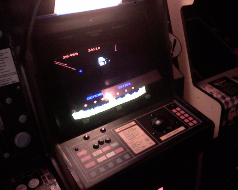

Obligitory cell phone pic. Not bad for starting out as a $150 non-worker.... New ball, rollers, bearings,and cones thanks to RAM controls. CPO and braze multigame from Arcadeshop. PCB by BitSlicer, and a not so terribly burnt K7000.
Looks like she might deserve new T-Molding now.
