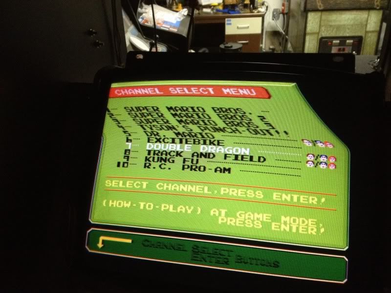

Hey guys thanks for the input.
My pc 10 does have a factory k7000.
I did purchase a bob Roberts deluxe kit with flyback(fit no problem) and did a cap kit and hot.
I'm getting this
I read that it could be the 50/60 pot so I messed with that first. I also replaced it with one from another chassis.

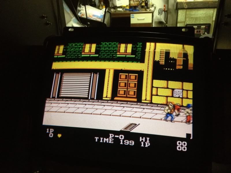

When the game starts I get this which looks more like the 50/60 pot.
So I said maybe I missed a cap or something and decided to recap again. Same result.
Any suggestions?
first pis was just a H-Hold adjustment there was no need to cap again.
second pic is a 50/60htz adjustment.

Which pot did you adjust, I guarantee it is the h hold pot? You'll have to fine the sweet spot that allows the menu screen and the game screen to look correct.

Now that you adjusted the 50/60 pot you may have to screw with it a bit again. I literally had the same exact screen, except it went down to only Game 1, Tuesday when I was testing a newly capped chassis in my Red Tent. Adjusted the H Hold Pot a hair and it is all good.
