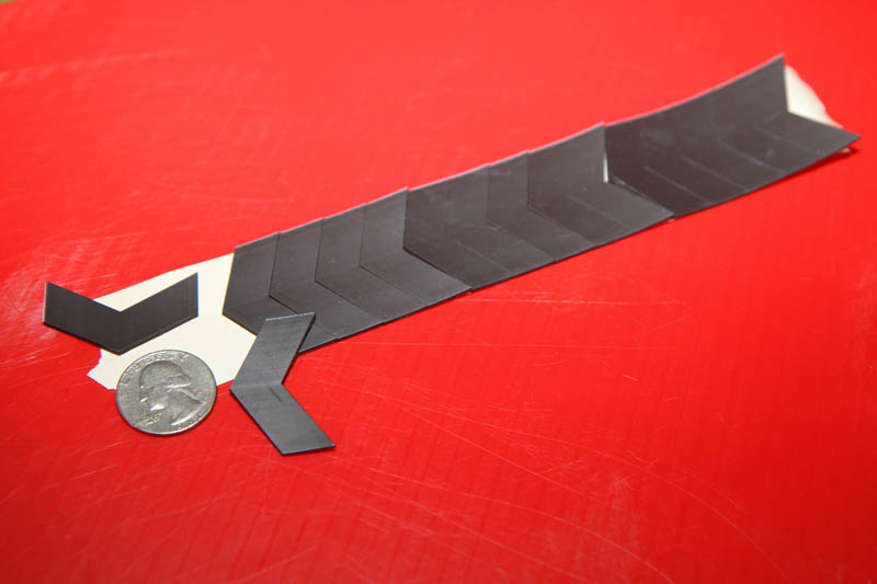

Right now I've got my K7000 close to the way I want it - I've even added and adjusted some convergence strips for the corners. But the last little issue I want to correct is the horizontal red (and maybe just a LITTLE blue). It looks good over most of the monitor but towards the bottom of the crosshatch/grid pattern it's just a little bit off (red horizontal lines are a little lower than the other colors.) There's also something similar at the very top of the grid -- the top one or two horizontal lines (may not be red).

I ended using another tube (same model #) and moved the chassis to that one. The convergence was a little off, but I was able to get it pretty close to perfect -- better than the one I was working on previously. Getting the static convergence (cross hatch lining up in the center) was fairly simple using moddset's tutorial, but the tricky part is getting the edges to line up (dymnamic convergence I think.) I was able to get the corners converged using some homemade convergence strips, but the outer edges (vertical and horizontal) were still off. I ended up loosening the yoke, removing the wedges and playing with how it was tilted. In the end I found that tilting it up was the sweet spot. I re-inserted the wedges into their new places (along with the help on another from the other tube) and the crosshatch looked nearly perfect.
I wasn't so lucky with the other (original) tube. Tilting and playing with the yoke really didn't help much with the outer convergence, even after fixing the corners with the strips. Since the purity tests all seemed to looked good (colors were on), I didn't mess with the purity rings at all -- with either of the tubes.

Also, some tubes I have seen use extra magnets in a v shape to aid in dynamic convergence. I wonder if that would help?
