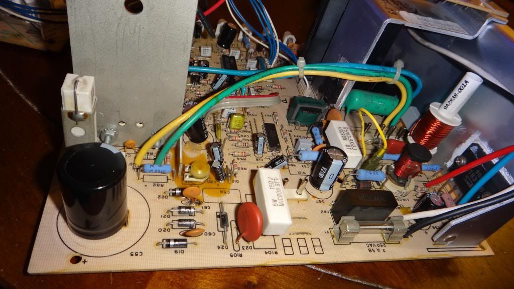

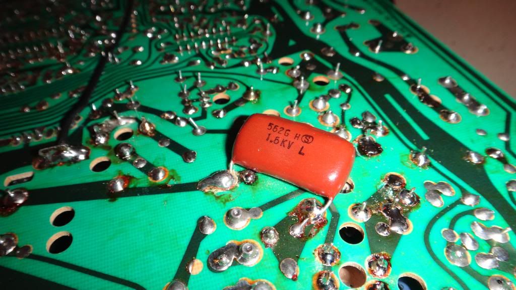

My C69 (soldered to the underside of the board) looks like a .0056uf instead of the .0061uf that everyone says is supposed to be there... I was wondering if anyone had seen a k7000 with a C69 of that value stock? Think it may have been someones best attempt at a replacement? I want to replace the cap and I have a 0061uf cap coming in the mail but I didn't want to try it untill I figure out if the .0056 is a stock value or not.. Any ideas?
Now that I'm looking at it.... That 4-leg green critical safety cap in C36 says 1600 432 H ... That means it's a 4300pf right? That doesn't match every other cap description i can find on the web... I think they are supposed to be 6100pf or 4700pf ... So Now I'm confused. I guess maybe I have an early version of the k7000 that has different values for both C36 and C69??
take a pic of the caps both sides of the chassis.

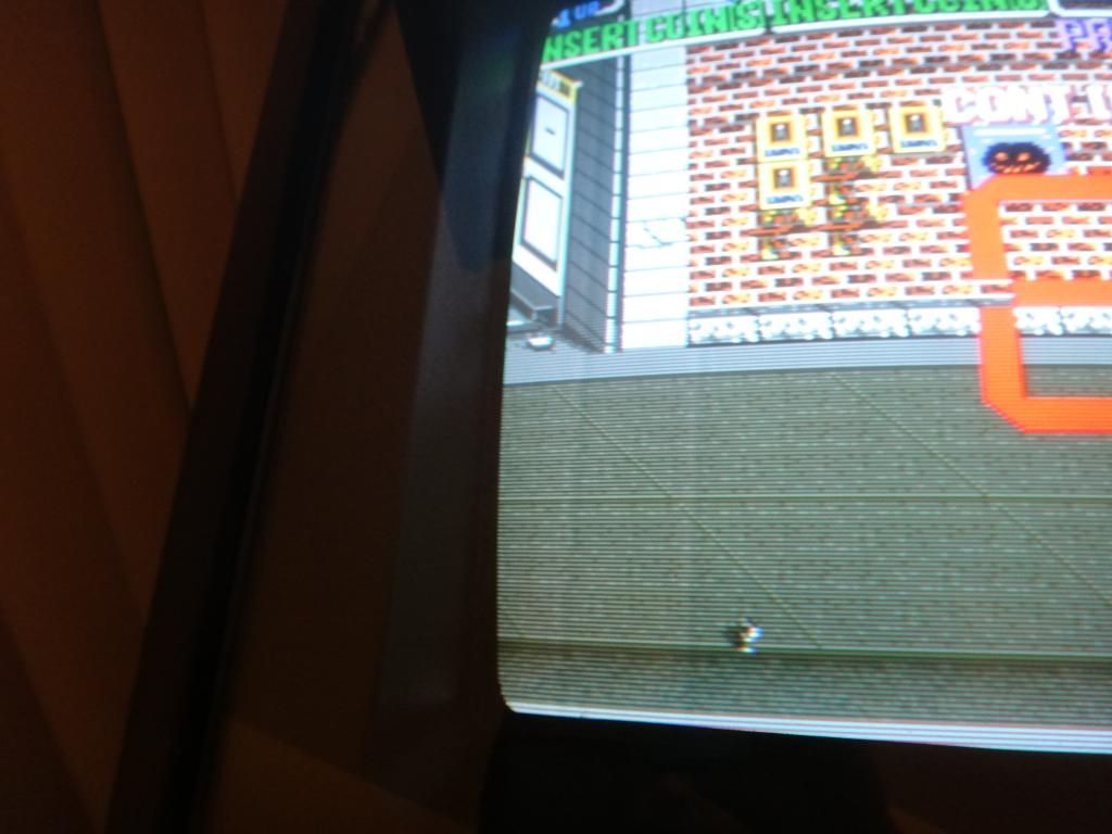

I'll have to take a few pics tomorrow after work. I posted about the problem im having a while ago. It has two vertical lines on the left side of the screen. C36 and C69 are literally the only caps left that I have not replaced on this board. It was showing just one line at first. After I did a cap kit it and replaced the flyback, it now shows two lines. I'm waiting for a couple ICs to arive in the mail but other than that I don't have any idea whats causing the problem.

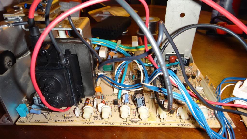

Here are the pictures of the two bars on the left of the screen and the two caps I'm talking about...
yes that is a factory mod do not change it.

Yeah the hard part is that if the problem is an incorrect value cap then it was put in there before I owned the game.. I verified that all the caps i put in matched the old caps in the board and also match the cap list from wells gardners website.. So it would be impossible to figure that all out.. But I did try a few different games with that monitor (in the same cabinet) and the bars are in the same spot on all games. I tried another konami game and a mortal kombat 3 board.. And I can confirm that its not burn in... When I adjust the width or horizontal position the bars move with the picture..

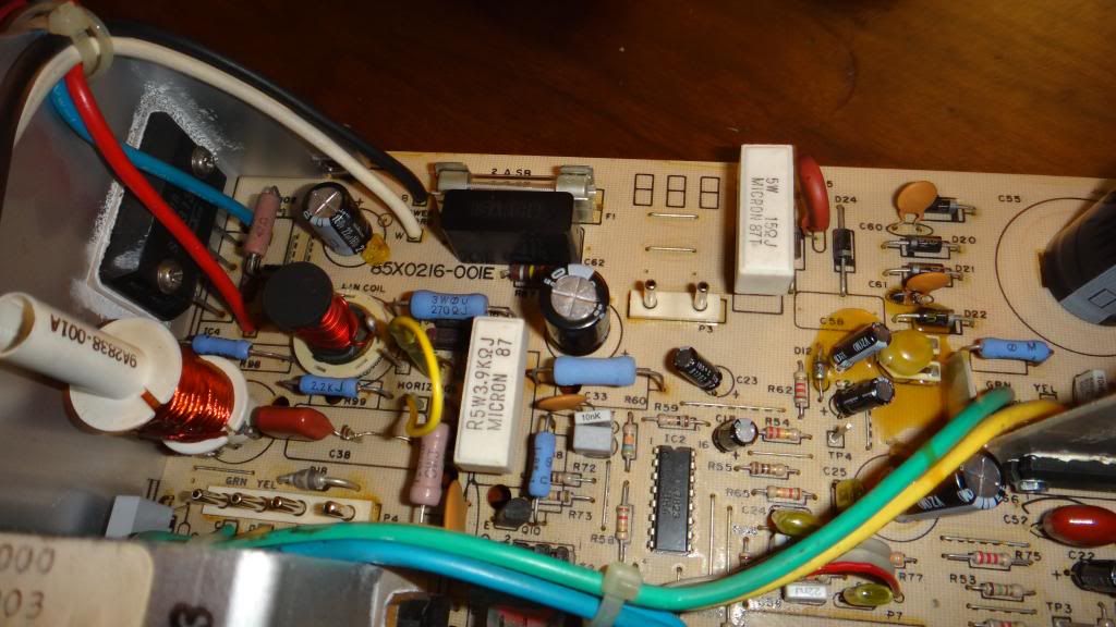

i would like to see the yoke readings and a pic of the chassis please.

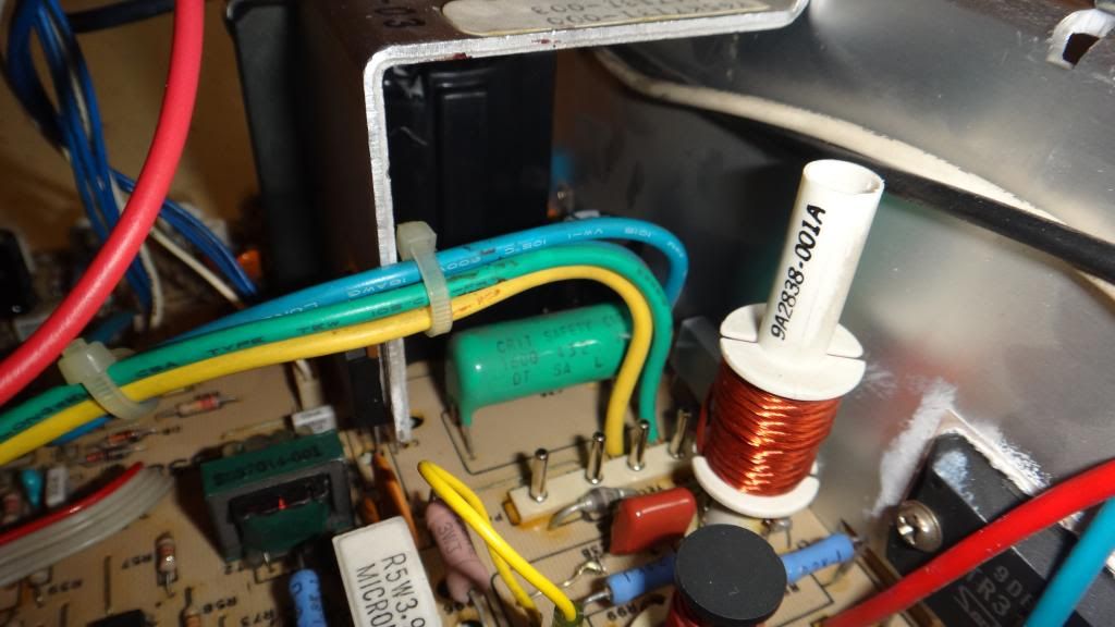

Hey Buffet, or anyone else who might know.. What's the little pcb next to the flyback? Is that a early pincushion or mod for 27"?
Also looks like the caps on it are original, might need to be replaced..
I've had issues like yours in the past.. After 30mins or so reflowing most if not all solder pads on the chassis, neck pcb, and remote pcb.. It was fixed :)
the square one by the fly with the 2 caps on it.
i do not know, i have never seen one hooked to anything.
9/10 times i just remove then and toss them into the parts bin.
it would be neat to know tho.

Yeah they are new Nichicons. All the caps you are asking me to replace have already been replaced. I replaced every cap on this board except for two. lol I have the original cap for C44 and it has the same results as the new box cap. I'm going to reflow everything on chassis next time I have it out just in case I may have missed something but other than that I'm keep an eye out for another k7000 to test in this cabinet.

remove the cap on the bottom of the chassis ..completely
one reason your image is to wide as it is..
adjust the coil up so the image is narrow then adjust it out.
if it wont go completely out then change the pf across the tuning cap
or add to a .0047
the box cap c44 is for the secondary of the fly may have some image
issue because it parts of the video B+
the Box cap next to the yoke connector would have more to do with the
width..confirm its good too.
The most that would happen is the set go into shutdown as the peak to peak
level gets to high and cause the x-ray protect to disable the drive chip..
I dont believe this will happen, so i would experiment with these the coil
and retrace tuning cap.
compare with the what you have in the chassis with what the parts list has
and then make the proper tuning adjustments between the caps and the adjustable
coil..Good Luck!
