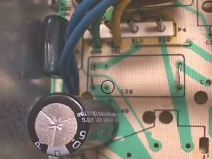

K7000 Blowing Fuses :(
D13 and D14 both read .534 on the diode checker setting. Not shorted. C38 WAS shorted and has been replaced. That stopped the fuses blowing, but now I am experiencing what is described two posts up.

No. Fuses do not blow anymore. Now I have no high voltage. There is only 68VAC at the output of the fuse holder. Nothing at pin 4 of IC4 and nothing at Pin 3 of P202 on the neckboard. I'll check the resistors and replace D13 and D14 just to see what happens. Also, thanks for filling me in about the VR. I have replaced it and double checked it (across pins 1 and 4) and it checks good.

I just went through a big problem on a Wells 19k7635 (medium resolution k 7000) that was blowing fuses. Let me fill everyone in on what happened.
Game came into the shop with a blown flyback (hole in the side arcing to the metal frame). I had recapped it a few months ago so it did not need any capacitors. Anyway, checked the horizontal output transistor and it was ok. Next thing I did was replace the bad flyback with a brand new one. Re-installed chassis and powered it up. High voltage was very low, only 8000 volts. Pulled chassis back out. Found capacitor C38 was cracked. Replaced it and re-installed chassis. Powered up and fuse blew immediately. Ok, I pulled chassis out again to start unsoldering things and checked for a shorted component. Could not find anything shorted!

Good info Ken. Unfortunately, the flyback was one of the first things I replaced. I installed a known good one. Still nothing.
The high voltage shutdown trimpot is also known to go bad internally.
lol, yup. Replaced that already too. I think there has to be a component shorted that's not normally looked at or maybe one of the other ICs. I already changed IC2.
