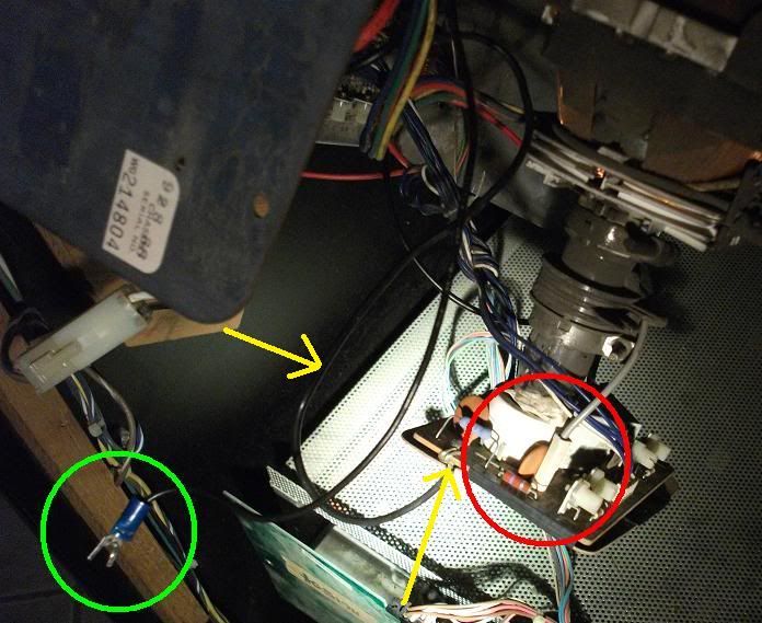

K7000 Arc/Spark Issue
Make sure the black wire from the tube is connect to the ground point on the neckboard....
Hmmm... the only ground point on the neckboard I see is a single pin (circled in red) which connects directly to the flyback.
The black wire from the tube is actually not connected to anything right now. (circled in green) I suppose that could be the problem! But I'm not sure where it is supposed to go. I tried connecting it to the chassis mounting frame but am still getting the arcing problem.
Okay, usually when I see that wire with the clip on the end like that, it goes under a screw on the top wall. There might also be a wire there that goes to the neckboard, and maybe not...
I just tried attaching it there. There is still arcing in the same location. I also looked around for another wire but saw nothing.
Could anything aside from improper grounding cause this problem?

Hmmm... that's what I was afraid of. (That the caps and flyback weren't the only issue). I do have a new HOT and fuse for this board, but I'm sure those aren't the issue. I decided it would be a good idea to have them just in case. But like I said, there was no arcing before I pulled the chassis out. So I'm thinking I did something wrong (whether while working on the board or re-installing it in the cabinet) to cause the arcing to happen.

It will most likely start arcing somewhere else. I've seen a big spark jump from the chassis to the tube.
First off, try doing a continuity check between the spring that stretches across the back of the tube, and a ground point on the chassis (with it installed). If you have no continuity, you need to make some.
Next, check over the chassis to make sure:
1) you trimmed all of your leads
2) nothing on the chassis is touching the tube directly (except by wires), just the frame... (Sometimes a new cap may be a little too tall)

Okay, I checked and know for sure that all leads are trimmed and nothing on the chassis is touching the tube.
The spring (actually, it is a sort of wire in this case) that stretches across the back of the tube connects directly to the wire that I circled in green a few posts up. So, are you saying that I should attach that clip directly to the monitor chassis itself? I thought the chassis was at high voltage. I have tried attaching it to the mounting frame before, (The big flat metal plate in the top-left of my photo) but that didn't work.
I know that my lack of knowledge on this topic is almost embarrasing, but I am always trying to learn more. You gotta start somewhere! :D
Okay, see this wire (yellow arrow) that is connected the neckboard with solder? follow it to the other end (probably a screw on the left wall). Attach that green circle wire to the same point...
Cool! That fixed my problem completely :D. No more sparks anywhere! Just a nice, bright, crisp, freshly fixed k7000 monitor in one of the coolest late '80s games ever.
