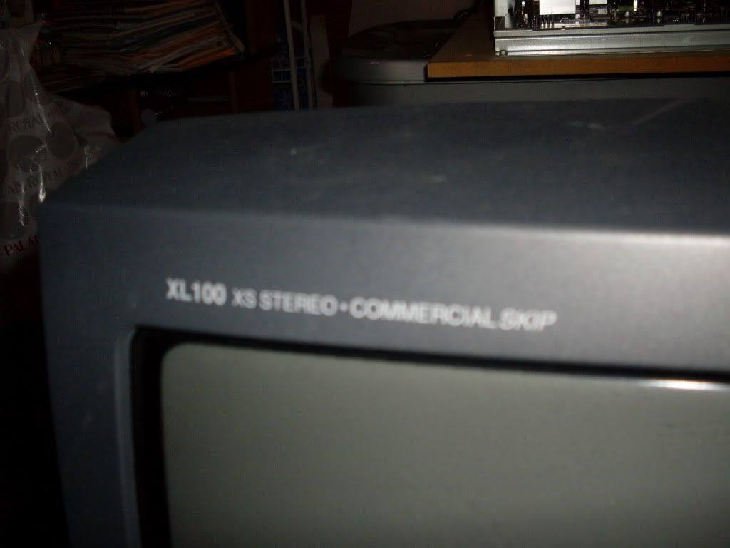

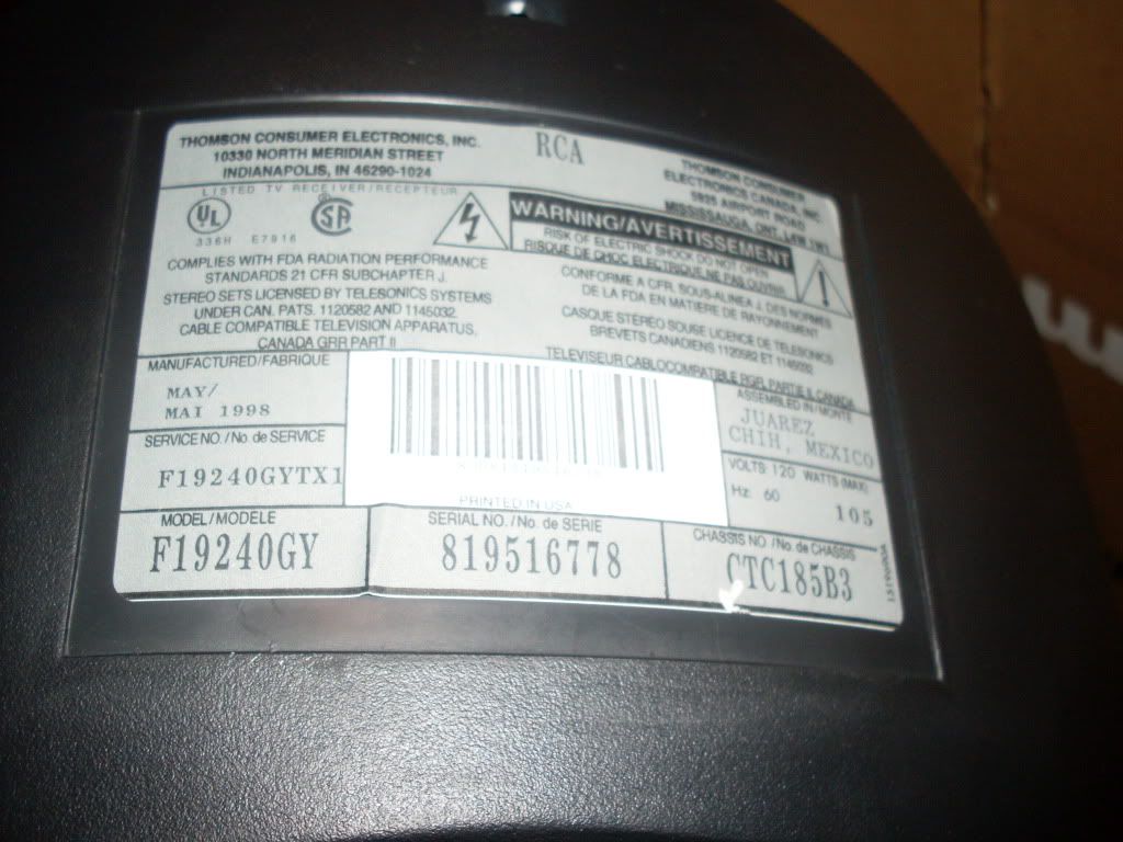

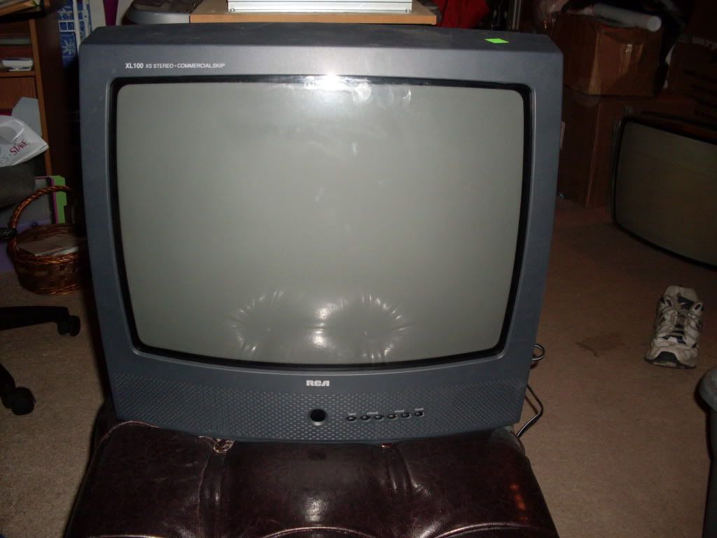

Now, I recently found an RCA at a local Goodwill that isn't on that list, but has a CR-23 neck. The tube is an A48AAB13X02.
Yoke measurements:
H - 3.8-ohms
V - 12.2-ohms

Warning: The Tv mentioned below DOES have the right tube, but the yoke is bonded, so you will not be able to remove it. Now I have to find a chassis that takes those yoke measurements and has a CR-23 neckboard....

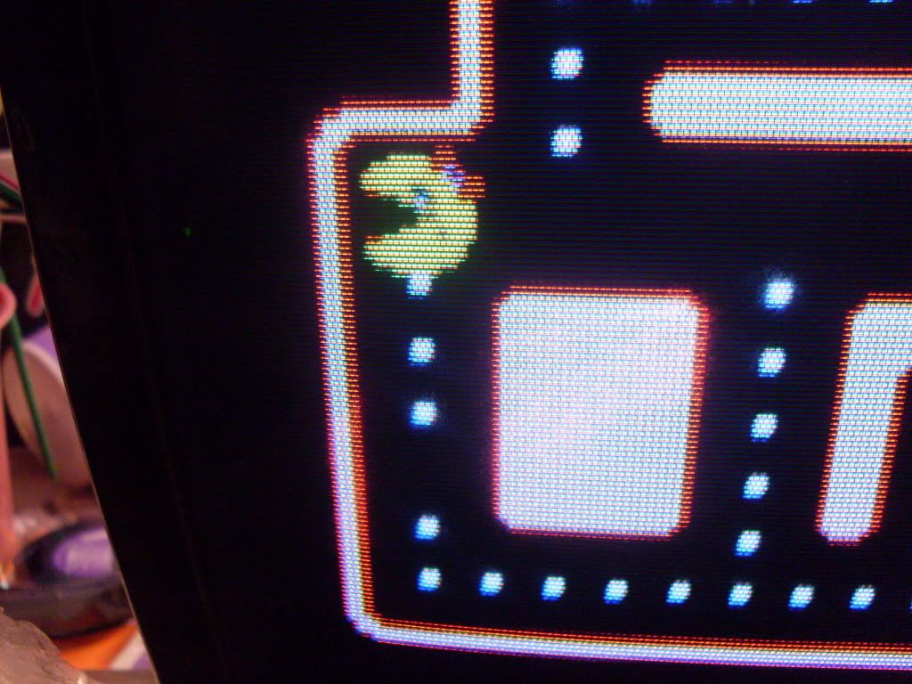

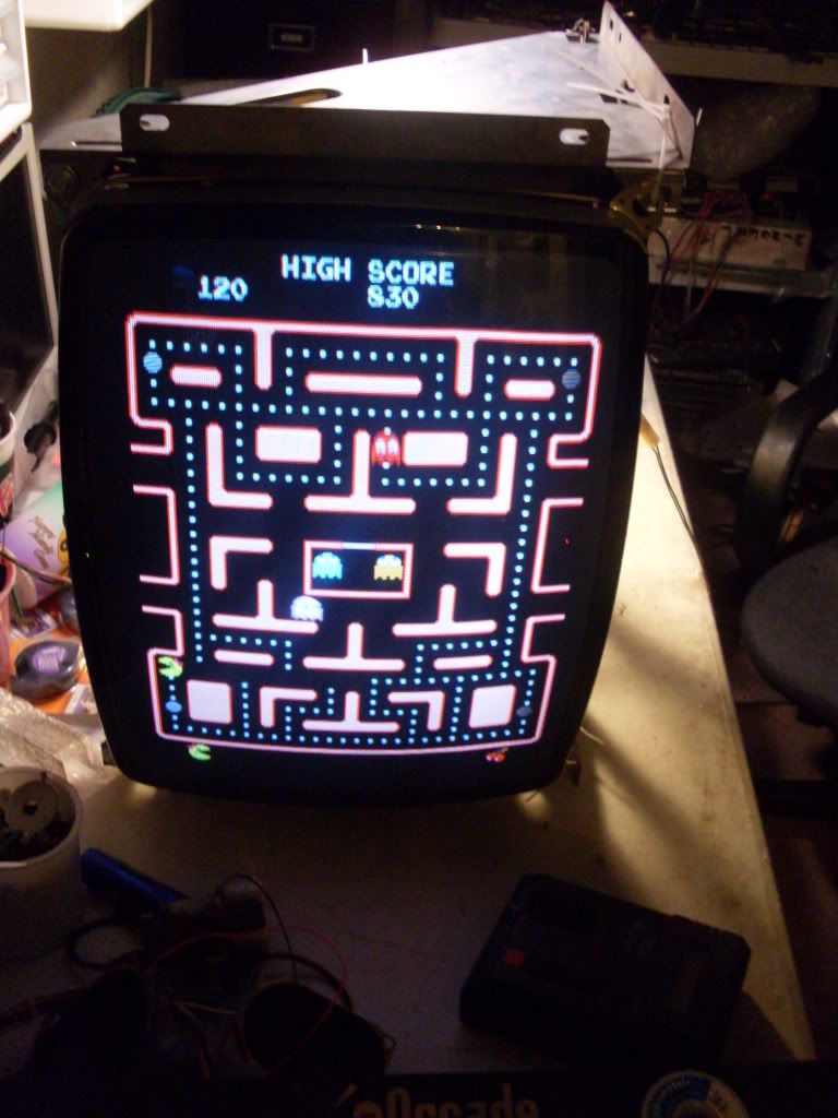

Well, good news. As the bonded yoke had pins on the top of the yoke that the wires connected to (similar to the K4600 yoke), and since the measurements were sorta close, I decided to hook it up to a K4600 - and it works! I had to decrease the vertical size, but I have a pretty damn good picture.
And I don't know why the pink of Ms. Pac looks so fade in the photos. It's nice and bright in person...
(if the image looks like it's leaning a bit, that's because I can't hold the damn camera straight)

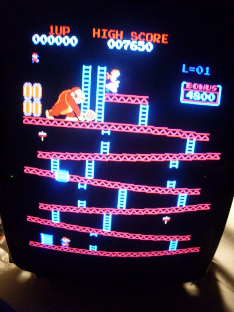

Well I got the swap done. The picture looks awesome with a few exceptions. First, on the left edge of the picture you can see there's a yellowish line. Not sure if that's something I can adjust out with the chassis somehow or what??? Second, there's a minor dynamic convergence problem in the upper right corner - the red is out a bit. I think I can fix it with a magnet but with the bonded yoke, I'm not 100% sure I have enough room to get it in there. Third, and probably the most bothersome to me, there is a bit of a pincushion type problem. These pics seem to exaggerate it, but nevertheless it bugs me a bit. Is there anything I can do about that? It must have something to do with the yoke and/or tube because there was no pincushion problem with the last tube I was trying (and I recapped the chassis a couple of days ago).
Other than that the picture is beautiful. Any ideas though on the first, and more importantly, the third problem? Is this what you get when you don't have an exact match on the yoke impedances?

probably. I also saw a slight bow, but it's not enough to keep me from using it in a JAMMA-swap cab...
I did a direct swap from a TV to a G07. I got a beautiful picture, but with a slight convergence issue, a pincushion bend on the bottom of horizontal axis, and one other tiny issue. I can probably most of them out, and there is a cap on the G07 that can have the value swapped out to help the pincushion thing.
