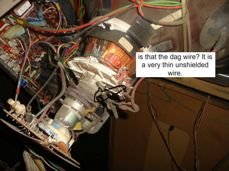

Is everything properly connected such as the DAG wire that goes around the tube ?
Hi, DAG? what does that stand for?
There is a line of glue and it looks like it has a wire in it.
It is cracked right where the color rings meet the glass of the tube. THE TUBE IS NOT CRACKED, but the line of glue, if that makes any sense,

Ok i believe this is my dag wire.
it seems like it is touching a few components, is it supposed to?
Also it is definitly the wire that had the line of glue on it. also you can see what i mean about the crack in the glue.

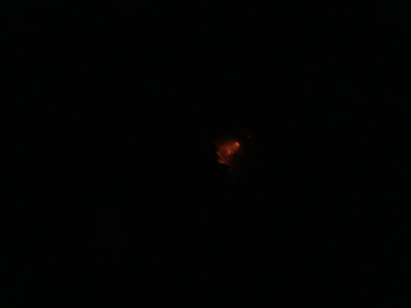

ok both these pictures are with the blk level down so there is no spark or blue glow from the tube, just normal orange
here is the screen when on
and the neck glow

The DAG wire prevents build up of High voltage static.
Check these pics out and see if it clears anything up for ya.

ok i see my DGA wire, it is hooked up and a wire comes from the dga wire to the back of the neckboard, it is soldered on. i tried shaking it around, no change.

The tube has an internal short, and you will need to use a rejuvenator to try to clear the internal short. If you are unable to remove the internal short, your tube is trash.

Just had a 4800 (13" version of the 4900) that had a blue lightening storm inside the neck. Turned out that the tube was shot, same symptoms and picture on the tube.
ok so its a internal short in the tube.

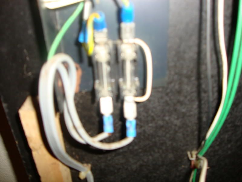

Ok will do, the fuse on the power board is soldered onto the board,
can i just test it like that or, do i have to discharge the monitor and actually yank the fuse before testing?
sorry for all the questions, but I figure its the only way to learn.
Update:
Ok i tested the fuse that is on the power board, the one that is soldered to the board and has a plastic jacket covering it,
I set my multimeter to the beep setting, and it beeped when i touched the two ends, so that means the fuse is good correct?
Also I have these two fuses and they both test good( i pulled them out of the assembly to test)

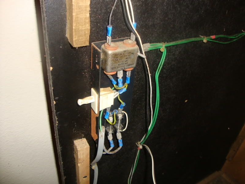

And what is the deal with this power switch?
When you push it in it turn the game on, but if you let go it pops back out and shuts the cab off.
If i pull it out it turns and stays on.
Is this the correct way to switch the cab on? that was the only power switch i found.
That's a safety interlock/service switch. It's working exactly as it should. when the back door is on it would hold the switch in to power up, when back door is off you have to pull the switch out in order to service anything/no power.
If you follow the lines that goes into that area, I'd bet you find a regular power switch. (maybe on top of the cabinet, maybe on the bottom)

Well i traced the wire comming from the two fuse block by the service switch and there is no other on switch.
