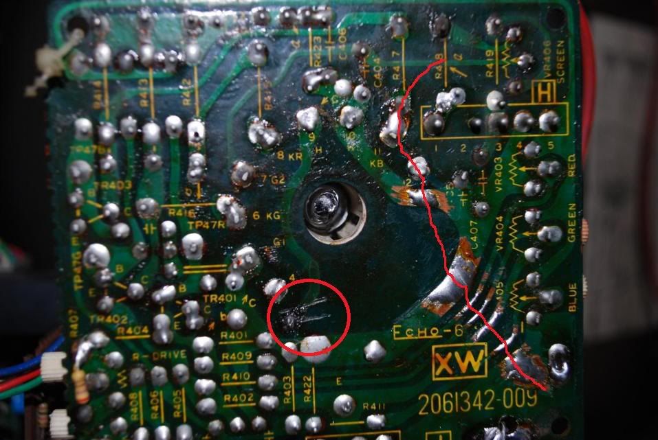

Looks like your neckboard has been cracked and then repaired. If I were you, I'd go over every single trace looking for another that isn't...
Here's a closeup of it. Maybe I should track down a new neckboard. It doesn't look cracked that I can see. Maybe it was scraped down that right side badly.
You can see where the crack is (traced in red) and it looks like some scratches on another trace (circled). Check continuity to be sure...
Something seriously weird is going on. I added more solder to those cut marks on the right. Now I get neck glow, but when I measure pin 10 I get 0 volts, but 4 from pin 9.
So this is what neck glow looks like! I guess I need to get pin 10 to light up. I get an ohm reading of 3.5 between pins 9 and 10 if that means anything.

To measure heater voltage, you should put a probe on each of the 2 H pins on the neck board. The reason you measured 5 at both pins before was because of the bad trace that you then repaired. You were actually getting 0V across the heater as no current could flow due to the broken trace. If the monitor crackles at turn on and then shuts right off, it could be in HV shutdown, which jives with the symptoms you described.

SUCCESSSS!!
I measured volts between pin 9 and 10 instead of from ground to each pin and get 4 volts.
But the good news is, I get RASTER! The screen is nice and white now. Well, it's actually tinted green, but it's lit up. I gotta take off for a bit and I'll check back later to play with it.
