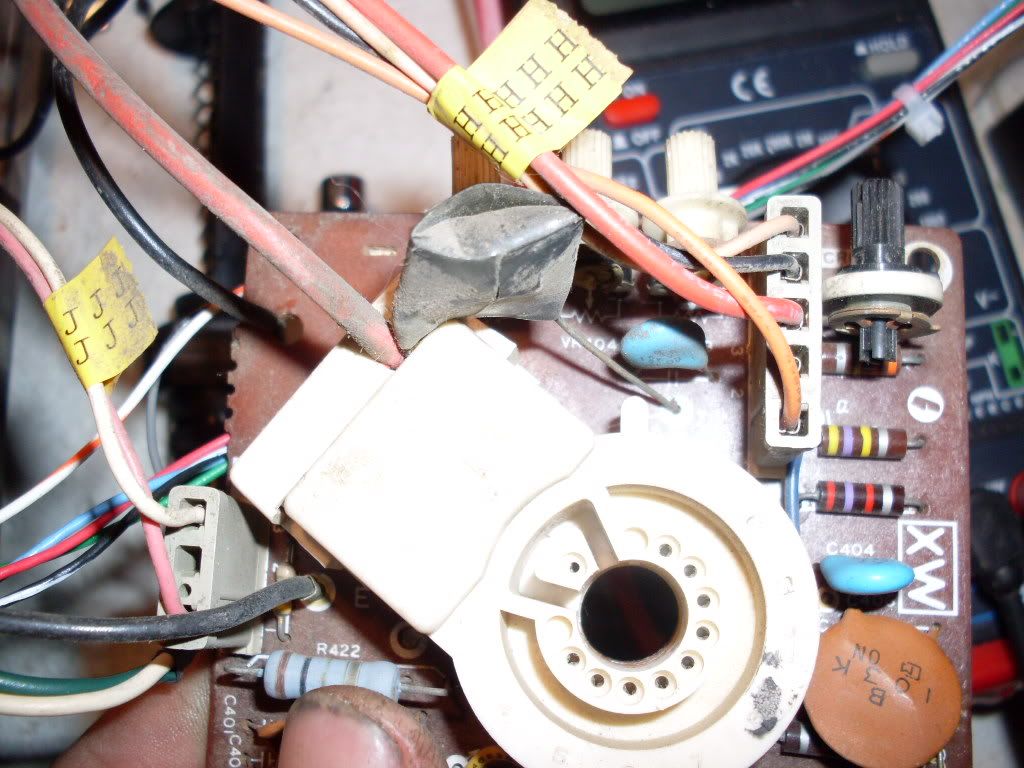

You know, now that I think about it, there is something weird about this neckboard (or I haven't worked on a 4600 in a while and don't remember).
There is something wrapped in black plastic/tape that goes from the focus wire input to the neckboard. I'm guessing there is a cap inside? If so, might it be the cause of my lack of complete focus ability?

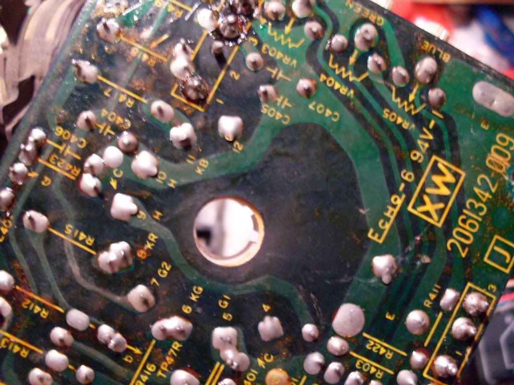

Checked the entire neckboard for cold solder, but don't see a problem:
no clue what that is, but I just checked my 4600 and it has the exact same thing as yours.
I was talking about the red wire going into the neck socket for cold or bad solder joint. open up the neck socket and check it.
Look like it is labeled as C405 (seen in my 2nd pic). It is a 100pf 12kv cap between the focus line and ground. I guess if it is devalued, it could cause a problem with the focus....

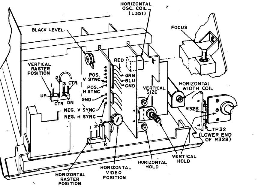

It's pretty damn close, so I may just leave it alone. If I drop the brightness down slightly, it looks better. I need to look up the vertical and horizontal shift jumpers for the 4600 now...
Okay, my board doesn't have the position jumpers seen in this photo. Can I just add them? Where does the other end of the jumper wire attach for each?
