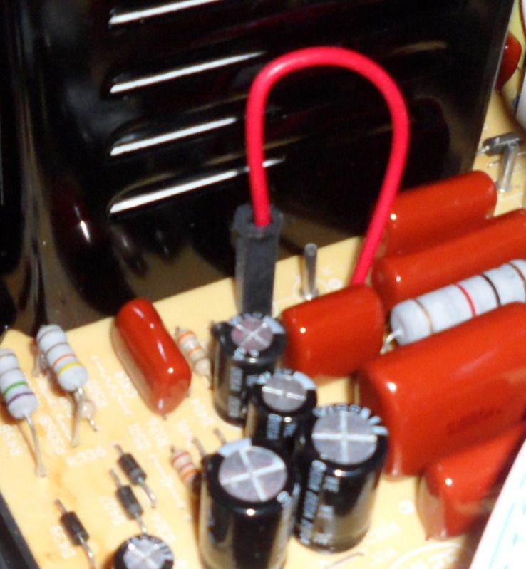

There is a jumper for "Narrow" or "Wide" I believe. It's a yellow wire that's going to a post near two other posts. It looks similar to this. Move it to the "N" or "Narrow" post and see if the width shrinks at all. Just my two cents.
not on a K7000 or K7000a there is no such jumper.
you have to change the width cap.
Peace
Buffett
That's strange because the one I just sent you has something like I described, but it's possible that it's function is not what I described.
