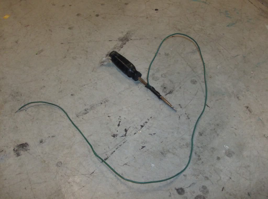

heres my hndy dandy discharge tool its been used for over 100 monitors and works like a champ
all i did was strip about 1 1/2 inches of wire and wrap it around the screwdrive a few times zap a little solder on it to hold it in place then wrap that in elect tape
and at the time i was a little parnoid so i wraped the handle of the driver as well in elect tape lol

How to make your own discharge tool:
http://www.therealbobroberts.net/sb.html
That's a very nice way to make a discharge tool, but it's way overkill. I just take a cleaplead and attach one end to a screwdriver shaft, and the other end to the monitor's frame. No need to make up a permanent tool, but you can if you want to. I used to have a screwdriver like that with a wire attached to it (only I just wrapped the wire a couple times and taped it) - it was too much of a pain to have getting tangled up in the toolbox for how little time it saved. Easier just to use a regular clip lead when I needed it.
-Ian
