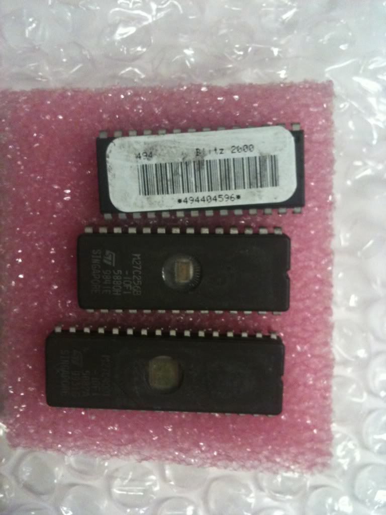

here is what i was given along with the setup...
now i dont know if these can be installed to the existing hardware or if i would need something along the lines of what i found on ebay in teh original post to do the swap.
can i "install" the provided pieces and then just swap the hard drive to a blitz 2000 setup?
thanks!
if those eproms are good and they match the security chip and the hard drive, you can plug the blitz 2000 chips and hard drive into a working blitz or blitz 99 and upgrade it to 2000.
If the board was working and after you swap the chips and hard drive it quits working, you either bent a pin or have bad chips.
If the hard drive is bad, pretty sure the board will try to boot and then complain about the hard drive.
You can't mix/match the boot rom/security chip/hard drive for those games but the board itself was the same for all of them.
So to play blitz 99 you need to have the blitz 99 drive, rom, boot rom, and security chip installed. for blitz 2000, the 2000 drive, chip, rom, boot rom.

so since i have the 3 chips for blitz 2000 all i need is the hard drive if im reading this correctly. also is blitz 2000 the same at blitz 2000 gold? i cant seem to find any info on a blitz2000 that is not "gold"
"Gold" is what they called the final version of Blitz 2000, with the final roster updates, etc. I think most sellers are going to have the Gold version.
The boot rom has to match the version of the HDD or it won't work. So you either need to instsll the 2000 chips and find out what version you have or you need to order a HDD and the matching boot rom.
I think you can see what version of the boot rom is on the 1st loading screen.
