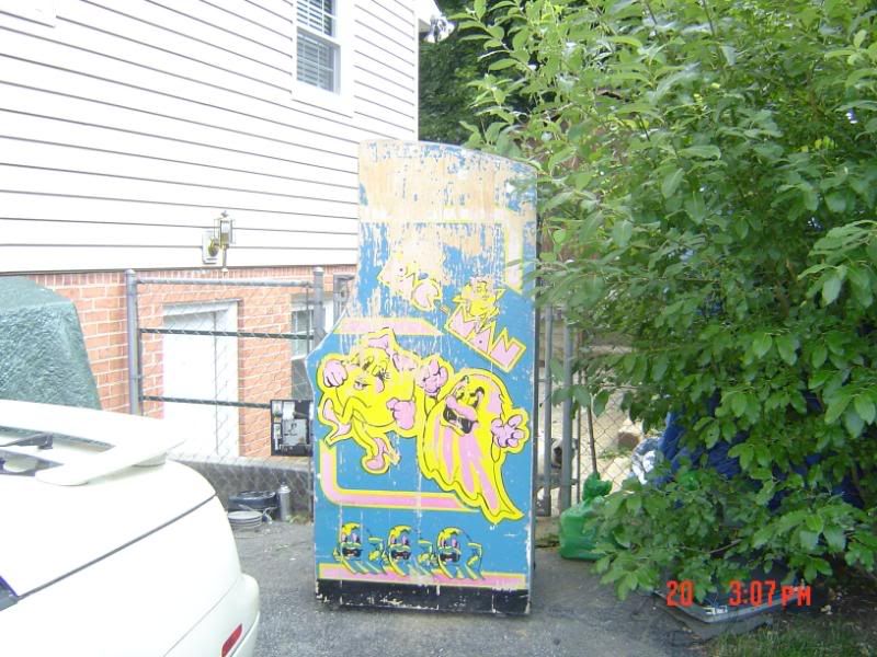

I decaled mine becaus eabout 30-40% of the sideart was either already gone or starting to flake off.
I couldn't be happier. I really like the way the decals look.

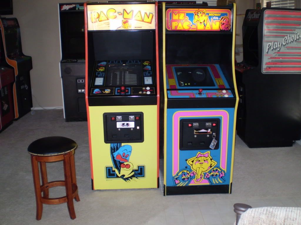

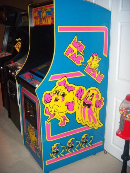

Here's mine:
My cabinet was really beat to hell. It had cracks in the wood that went the length of the cabinet. I had to bondo it for what seemed like an eternity. Then it was prime, sand,and finally I ended with a couple coats of blue paint that I lightly sanded and cleaned. I was worried about blue under the sideart, but you can't see it at all. I did that based on someone else's recommendation. I think the theory is that if you get a scratch in the art, at least it will be the same color underneath.
I had the art matched by computer at a paint store. I painted the back and top with it too, so it all matches.

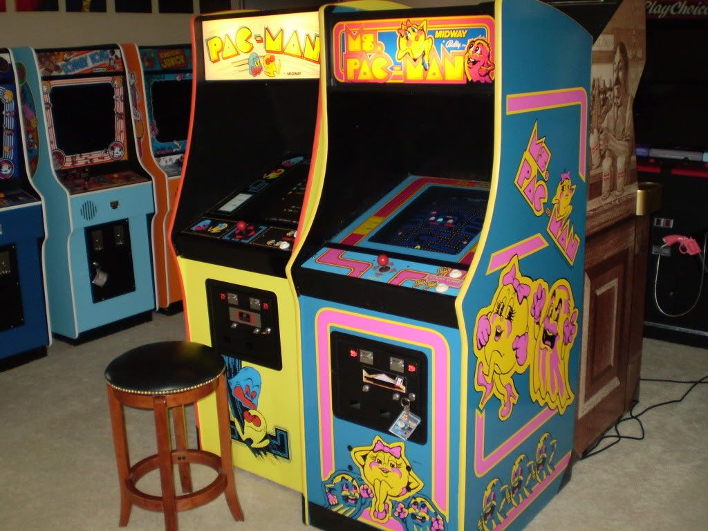

As for the front, mine turned out perfect, and I have a great method for it. First, take off the coin door and measure the original art's distance from the hole. Keep those measurements! When you get ready to apply the new art, lay it on the cabinet and shine a light from inside the cabinet, through the coin door. This will illuminate the square of the coin door hole. Line the art up with the hole according to the original measurements, put a heavy weight on it or tape it in place, and begin to apply the art starting at the bottom of the cabinet. I did NOT precut the art for the front. Instead, I just squeegeed the art into the corner as best I could with a thin plastic squeegee. Then I used a razor blade and a straight-edge to cut it along the corner.
My front:
The black is not paint. It is a plastic "kick plate" that protected the art from people's feet in arcades. Since it's now in my basement and gets played maybe once per week by me only, I'm not too worried about it getting scuffed. I saved the old one if I ever want to put it back on.
