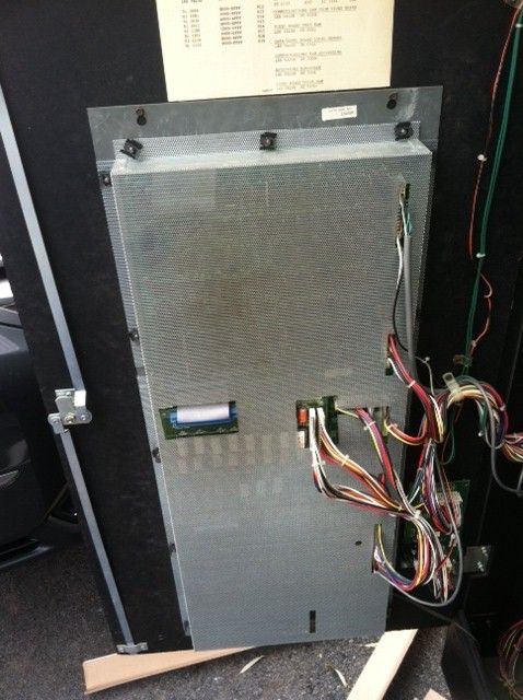

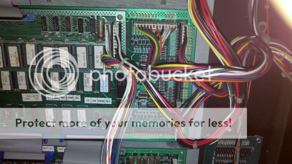

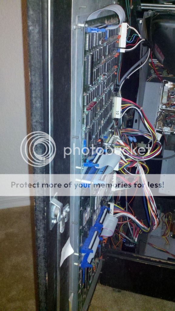

I am dieing to play this game but I want to make sure everything is hooked up right before hitting the power. I think I have it right but the manual says there are wires where there aren't any and leaves out a clear description of the rom board.
Local413 was the mastermind behind the repairs. My boards were quite toasty from a failed power supply unleashing hell on them. If someone that knows can look at these pics and give me a thumbs up that would be cool.
Thanks for looking. I hope to show you all a working game very soon. :)

The Video board looks Like it hooked up correctly..
Sound board Looks Like the same.
It looks like the sounds board is hooked up correctly.
Can not tell on the rom board since QIX And Zookeeper Differ how they are hooked up

I did look and it is not accurate from what I see. I looked for a while at the wiring diagram and thought I had it right based on the routing of the wiring.

Also, I tested each pcb and they are all working.. Except I forgot to check if you have the patched rom (19)
I think?? It's for the coin pcb.. Without the coin pcb, and or patched rom your game won't work. Or it will go a bit loopy..

Have you repinned the harness? That's a HUGE point of issue with Zookeeper and qix. The boardset probably works fine, just harness pin issues.

Well my right thumb really hurts from going through every pin. I took each pin out, they look new btw, and made them a much tighter fit and cleaned them. I have the same bullshit going on. Fuck this game.
if you have a known working board set with a new switcher the only problem can be the pins....i had the same issue...new pins did the trick not cleaning them....my problem was the pins on the small rom board iirc, but i ended up doing them all..
I hear what you are saying but when you pull each pin out, bend it out so it is a snug fit when reinstalled, clean with contact cleaner and reinstall, I just don't see the difference. The pins look new by the way. They are not corroded. I could put one of these pins side by side with a new one and it would be hard to see the difference.
I appreciate the help but this should have worked if it was a pin issue. I am now thinking the harness needs to be tested end to end for a broken wire.
If you guys insist on replacing new looking, tight metal on metal contacting pins for new ones I will do it. It just seems odd to me is all and is a lot of work on Zoo Keeper to just epically fail again.
