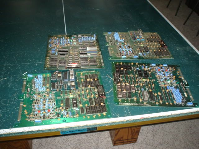

i ended up hauling 4 vs boards with vs platoon,vd goonies ,vs super mario bros ,vs rbi,

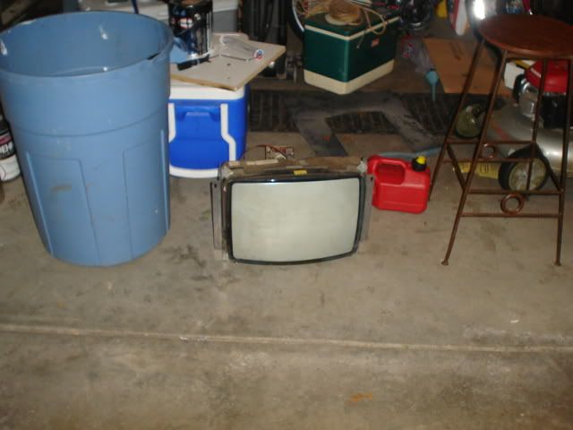

3 assumed non working monitors 2 4600's and a go7 all had chassis only one had any burn

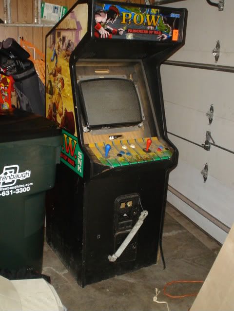

and a p.o.w with bad monitor in a 19 inch dyname cut corner

wtf is up with these vs boards all will boot on my red tent and play the roms on the second side but side 1 only plays a blue sreen (no matter what combo of known working rom sets)
they are mds 04 and 05 boards
i thought the vs boards were universal for either unisystem or dual system
i have the same problem with the mds 05 board thats in my upright smb cab
is there a jumper im mising or setting i need to set for the boards to output to bolth games /monitors
here is the vs boards ill get the rest up as i unload the truck (lol gotta make rooom in the shop first )

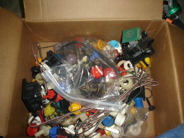

almost forgot also got a huge box with nintendo and other leaf switch style buttons and a whole bag of ball top joys
well got 2 of the 4 boards fully working hit the edge connectors with an eraser and sprayed out the chip sockets and reseated the chips/daughter cards
i only have 1 set of games roms left lol (vs golf ) so ill swap some of the ship sets into the other 2 boards t be shure they work fully then ill have 1 for sale with vs golf and another empty board

pow missing 1 buton and bezl blays blind has a wg 19 inch 7xxx series monitor has neck glow

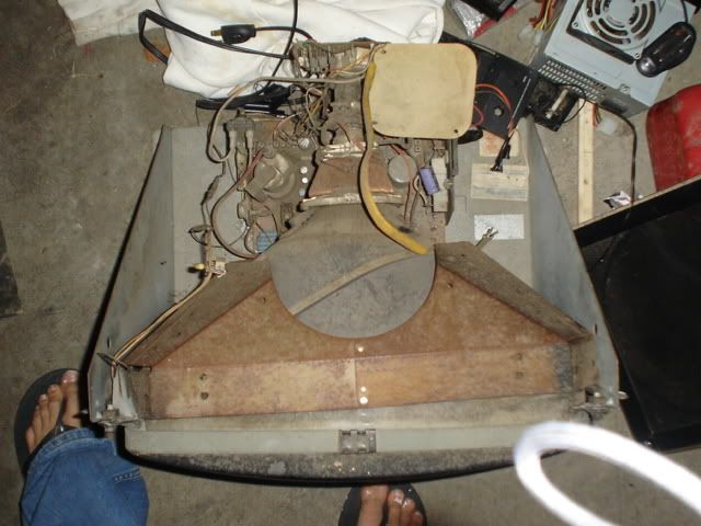

4600 with burn not bad tho (stil have the other 4600 in my front seat its burn free )
and a go7 with a little stargate burn (lol looks like they had the monitor in the cab upside down or someone has rotated the tube)
edit lol after looking at my pic yes some rotated the tube lol

yes but when i place 2 games like i was doing it was playing blue screen on one side and other game would play fine
just fingerd it out guess my vs golf romset went bad i was using that rom set to test the boards decided to retest the boards again and tried 2 daughter cards instead on golf and a daughter card bam all 4 boards work i guess i had m vs golf chips in the light to long it must have erased some of the chips as the rom set worked fine a week or 2 ago when i pulled them
