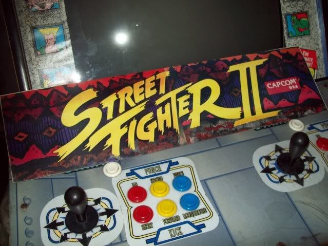

Whats with the marquee? Certainly light wont shine through the cardboard. Does it peel off or am I missing something?

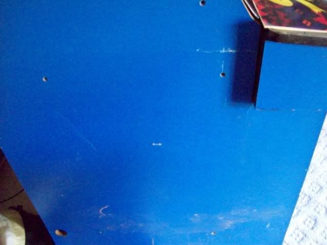

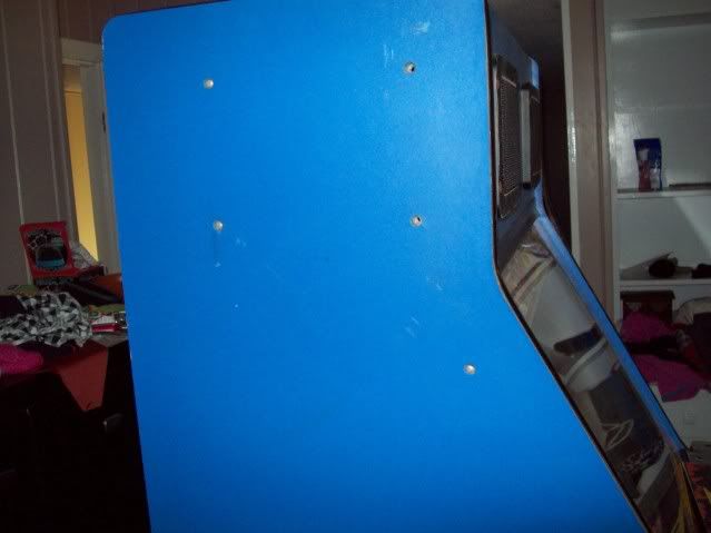

These are holes with metal threads inserted. What went here? Maybe side art with plexi over it? The other side does not have any holes.

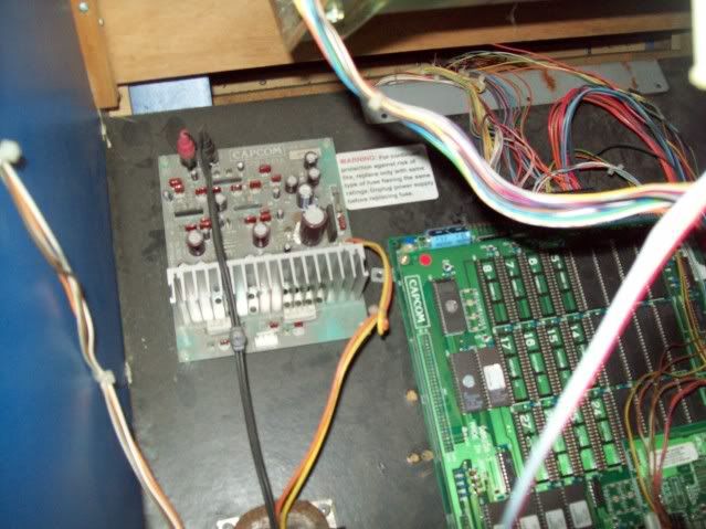

Above is th Q sound amp. The RCA wires arent hooked up so I dont have Q sound. I see no where to plug them in????

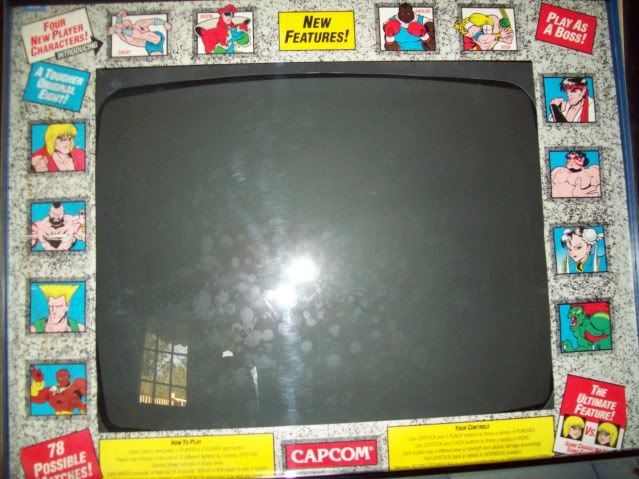

This bezel indicates some other version of SF2 that is not in this cab because when I play you CANNOT choose to play as a boss! Someone actually downgraded this cab to the original SF2. Does this have anything to do with the Q sound not being hooked up?

-Marquee might have been put on cardboard, could have been adapted from a cardboard bezel, something like that. The originals definitely are able to be backlit, though admittedly I've not seen a SFII WW marquee up close in a whooooooole lotta years. I have a couple SFIICE marquees that are peel & stick, but they don't have cardboard backing.
-Not sure about the screw holes. If they're there on one side and not the other, it's likely something an operator did to them on route.

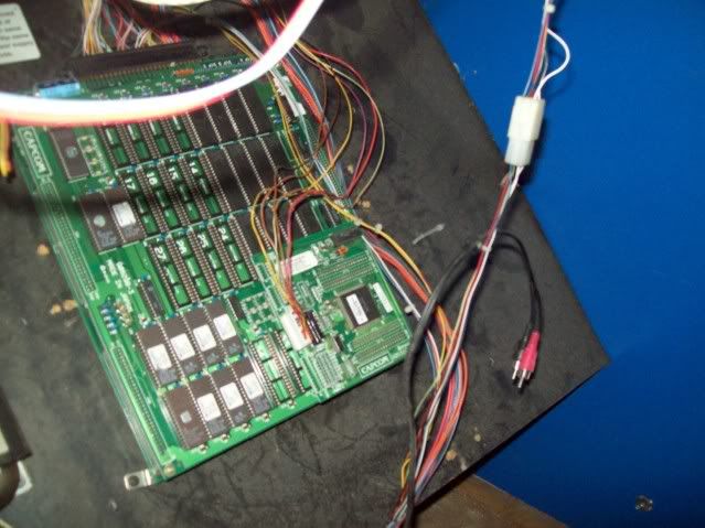

-That's a Street fighter world warrior board, CPS1 system, which didn't support q-sound. I think that started with the CPS2 stuff. Not q-sound compatible either was:
-The bezel is for SFII Champion Edition. That's the one which started w/ being able to fight as the bosses and do character vs character.

Since you can't play as a boss you most likely have the World Warrior board set. The marquee matches this as well. A board that uses the q-sound option will have a place for the audio cables.

Based on the layout of the eproms on the medium sized board of the 3 stack it's definitely a WW board. Champion edition has nothing in the low right slots relative to the shot of the board, the CE eproms are in the first empty slot above it and in the slots under the smallest board. The eproms are also in different spots on the left side in a CE. Yes, I've spent too much time looking at SFII boards. :)

Q Sound first appeared on what you could call "CPS 1.5" which include a small family of games like The Punisher and Saturday Night Slam Masters. They are basically CPS 1 boards housed in a plastic case. My dedicated Saturday Night Slam Masters is in a similar big blue cab.

Could be someone found a peel and stick marquee for WW (I have no idea if they existed for WW, I'm fairly sure they didn't) and put it on cardboard, could be someone cut down something else that had the SF logo that big printed on cardboard.
{PERSONAL THEORY}I think the peel & stick marquees for champion edition were limited run things for early conversion kits sent by capcom. The marquees for the dedicated champion edition machines were screen printed on plexi/lexan, I have two different types of peel & stick marquee, one of which I know to be part of the artwork set for a very early type of CE conversion kit (yellow/black instead of white/black coloring, some other color differences). The other is a dark grey/black, I'm guessing once peeled off and stuck to a blank piece of plexi/lexan/whatever is the normal translucent static coloring black/white. Both pieces are NOS and I haven't peeled them, as I haven't finished scanning them, but they're on backing similar to other adhesive products and they're definitely not translite or printed plexi. It makes sense that they would have been made available with the early conversion kits so operators could just peel & stick over a clear piece of marquee plexi they might have before the more complicated to produce art was out there with the dedicated cabinets. Just a function of trying to get the new product out there earning money as interest in SFII may have been waning in the fastest way possible. Given that I'm almost positive it was only done for CE conversion kits, I doubt the peel & stick was done with the original World Warrior marquees.{/THEORY}

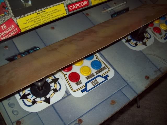

Can anyone tell which version of SF2 the control panel overlay indicates?

The CPO looks to me to be from a SFII CE kit. Open the control panel and look at the underside. Are there any extra holes, possibly that are filled?

Definitely not the CPO from a CE kit:
http://www.mamemarquees.com/streetf...p-1402.html?osCsid=k4gfjh796rhpmaknkevvgjm5b4
Not sure what the CPO was, I can try to hunt it down through the list on the wikipedia entry I posted earlier, don't have the time for it at the moment. At the least the Q-sound decal is original to the machine, those were made for the q-sound games. The dedicated SFIICE's were in 19" monitor generic dynamo cabs or in the big red z-cut 25" monitor cabs made by 3 Koam. 1993 on the stickers is a good start, SFIICE came out in 92, I'll try to do some digging when I get home tonight. As far as what you should put in it, go with whatever out of the q-sound supported games (as listed in the link and the couple extras SuperGunGuru pointed out) is your favorite. It'll keep your interest for longer, for sure, unless you're just trying to put it back to original and sell it.
