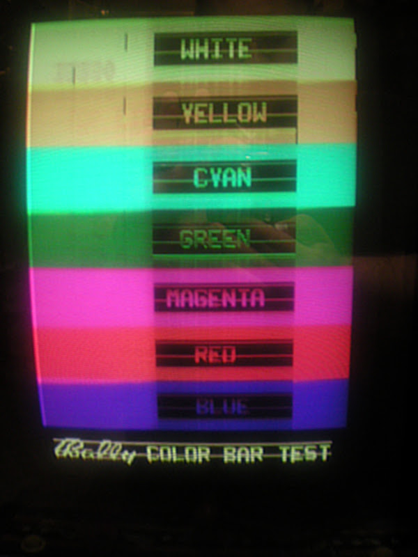

Also in the video the monitor has no blue, but I adjusted the neckboard a little and got the blue showing up.
I figure this will need a cap kit, but I really want to focus on the vidiot/mpu issues first. I can always get another 13" monitor.
Please advise. Thanks! :D
Well, for starters, what's wrong with it?
-Ian
I did ramble on in the video :D, but I get to that at 3:16, you can skip to there.
I believe that the issue is communication between the MPU and Vidiot. Vidiot LED blinks 10 times, I didn't count how many times the MPU LED blinks. When you power it on the it plays the pac man audio and never finishes booting. If I press the video test button twice I get the color bars.

Just the connectors not the wires themselves, sorry. This is a common problem in pins of that era as well. The factory used IDC (insulation displacement) connectors and they tend to get weak over time. As they weaken they build resistance and eventually overheat and fail. When the connector has been through one of these heat cycles they damage the header pins as well. It all snowballs until the connector completely fails, hopefully though an open but sometimes through a localized fire that damages more of the wire as well as the board. However, before the final failure the signal loss through the connectors gets bad enough that it causes communication problems between the boards.
WOW! Would I be able to see this with visual inspection?
If it burned, yes. You will be able to see discoloration, sometimes the connector has even fallen apart. If it has simply opened a visual inspection will not be as good as a resistance check with a meter. The problem with using a meter, though, is you will move the wires around some just putting the meter on the wires or board and this slight movement may be enough to give you a good reading that will go away when you remove the meter (or at some point later in time when the wire shifts back). Replacing all of them is best, though it is time consuming.

I think its a misconception that the connectors and wiring are the cause of the issues in these. Its usually caused by acid damage which will corrode the headers and IDC connectors. You should also bit the bullet and replace all the sockets on the mpu and videot boards. I have seen many times where they look pefect but when you desolder the socket the legs are corroded off under the socket.
With the info on the Marvin3M site you can get that machine up and running in no time. Its a very good site and tells you everything you need to know to repair these. I built a bench harness to work on the videots, it so much easier on the bench.
I am lucky that the MPU battery on this baby pac has not leaked. Wow i have never seen a socket where the legs have corroded off! Seems like I have a lot of work to do. I wonder if it is worth it to me to build a test harness, since I am only fixing on baby pac.
