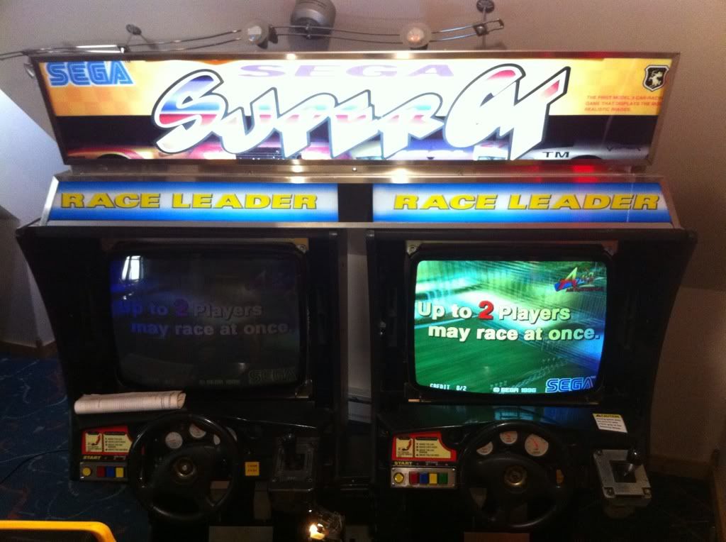

Well, got everything assembled.
One monitor has a great picture once I adjusted it a bit.
The other is dim and is missing blue.

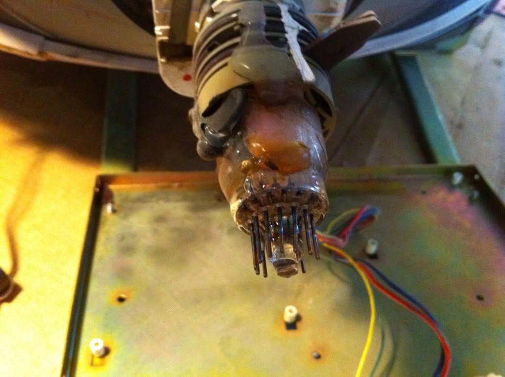

Well, swapped Chassis and the dim tube stayed dim.
Sigh..... Not a good sign.
Dammit I know what he's gonna say about my choice of the machines.
My spare tube won't work either, 9 pin vs 10 pin neck.
Any chance buffing the neck pins would possibly help?
They looked crispy, neck plastic was mostly gone.
On a more positive note, the "bad" chassis looks much better on the good tube.
Still missing blue, but otherwise bright.
Both chassis have transistors that are loose on the neckboard.
Any ideas on how to mount these if the traces have come loose?
The good chassis looks to have had a meltdown on the choke (will post a pic), someone just put a jumper in it's place.
I may end up buying a parts machine.
Hate parting anything, but a bad tube is a show stopper for me.
