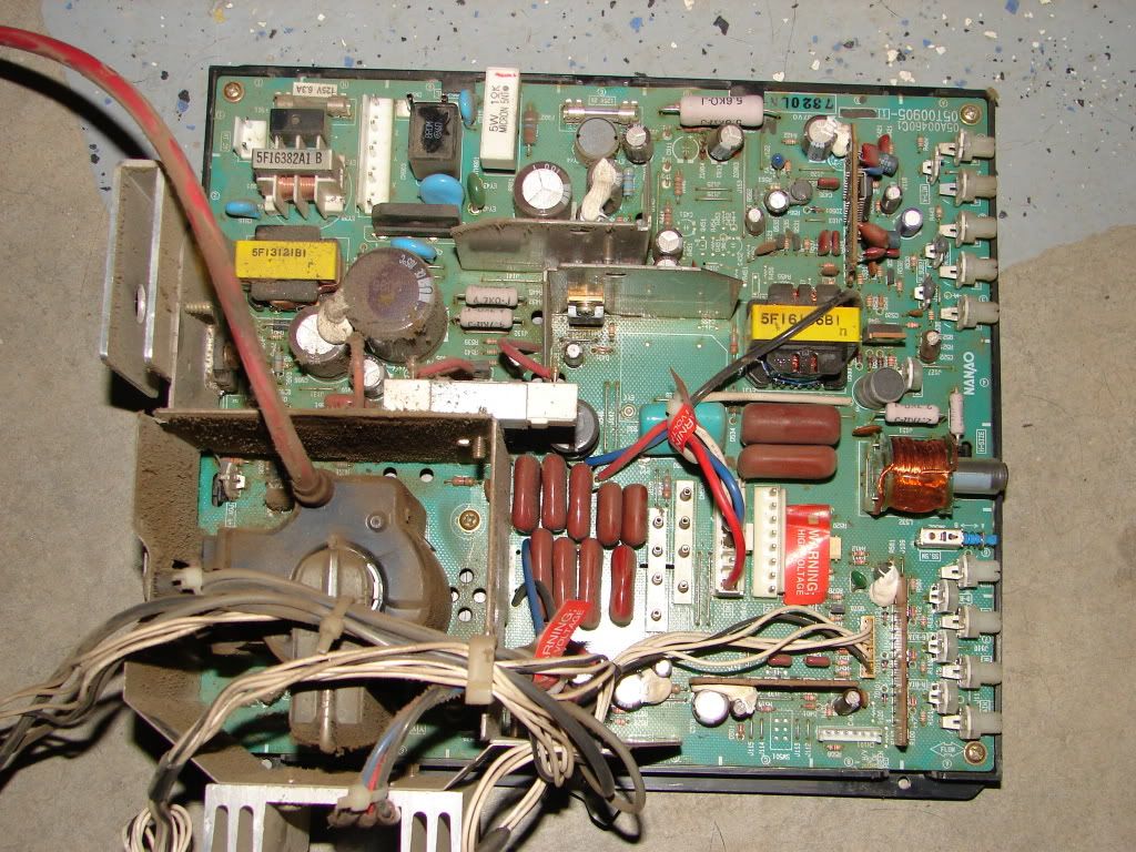

Ok, I redid the solder on the flyback and video inputs and still have the same problem. I don't know how to describe what I am seeing and I'm having trouble catching it on camera, but the there seems to be some distortion in the back ground just before it blanks out??

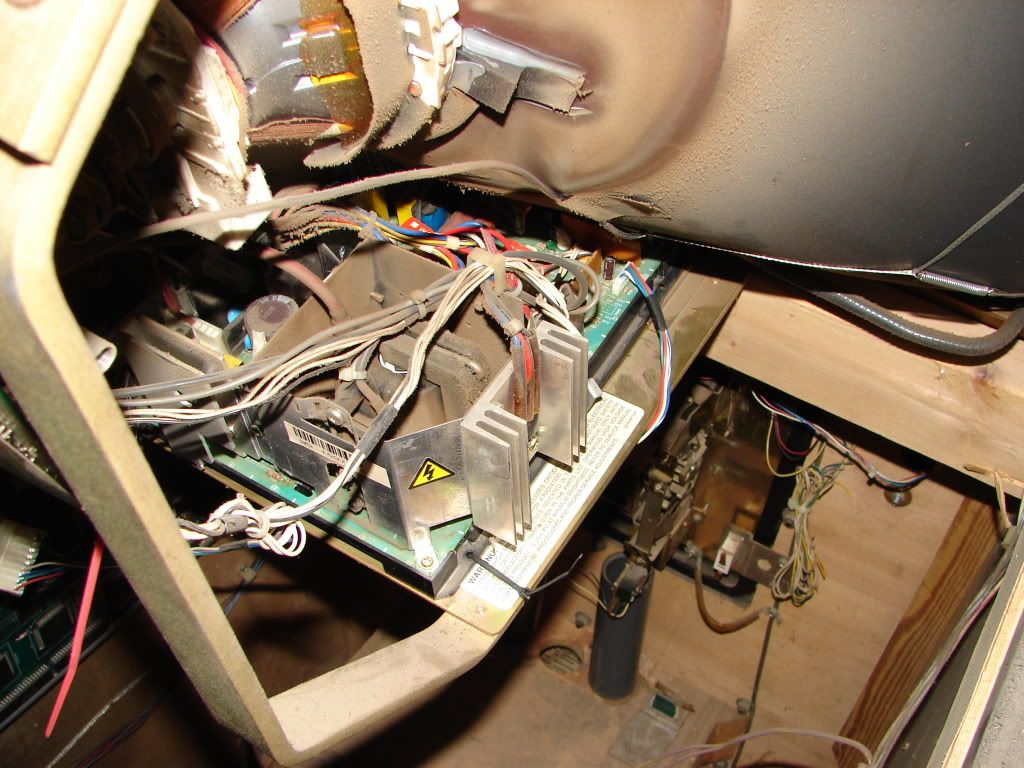

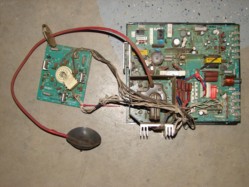

can you post a pic of the chassis so we know wher we are dealing with?
I found
NANAO 05A0046001 and 05T00905
Is that the chassis that was in your machine ?
You started off with a Wells Gardner serial number and now you're showing pics of a Nanao chassis.
somewhere on that chassis is some resistors that run real hot.. almost guarantee that you will find burnt/crackes solder connections somewhere around there...
that looks like a nanao dual res, mostly used on sega games of the early 90s...
check the solder of those resistors to the right of that large filter cap first...
hopefully this was just a frame swap as in somebody took the nanao chassis yoke and tupe and dropped it into this wg frame...
pretty weired that the wg serial number is on the chassis though.. odd indeed.....
