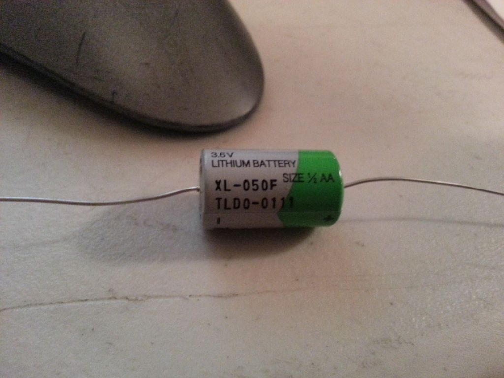

61 also pops up due to low battery because it causes corruption of the CMOS. You won't be able to clear it via the white button until you replace the battery. It's a 3.6v Lithium 1/2AA Axial-lead battery. Batteries Plus sometimes carries them, or can order them for you if they don't. Make sure you have the right description, as lot of folks don't know what an "axial-lead" is.
Here's a pic of one I got from Batteries Plus:
Once you install it (solder it in), you put your pcb back in and turn it on. You'll get the 61 error again. Then hold the white button until it goes DING and you see 61-1. Then turn Jackpot Reset key. It should either go blank or change to 65-3. If it goes blank, shut the door and you should be good to play. If you see 65-3, push the white button once to get to 65-1. Then shut the door and you should be ready to play after it starts up...
