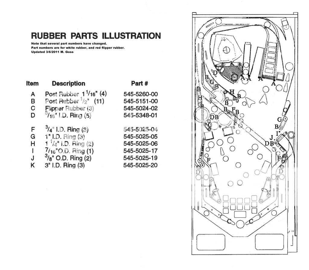

does anybody have the proper list of rubber to order (if the manual is so wrong)?
Just starting to re-rubber the JP. My tear-down notes are incomplete. I will try and get a better rubber ring chart up this weekend. Until then, take the previous list with a grain of salt, I keep finding more errors with the list in the manual and with my notes as well... Bummer.
OK - looking forward to your ring chart...
