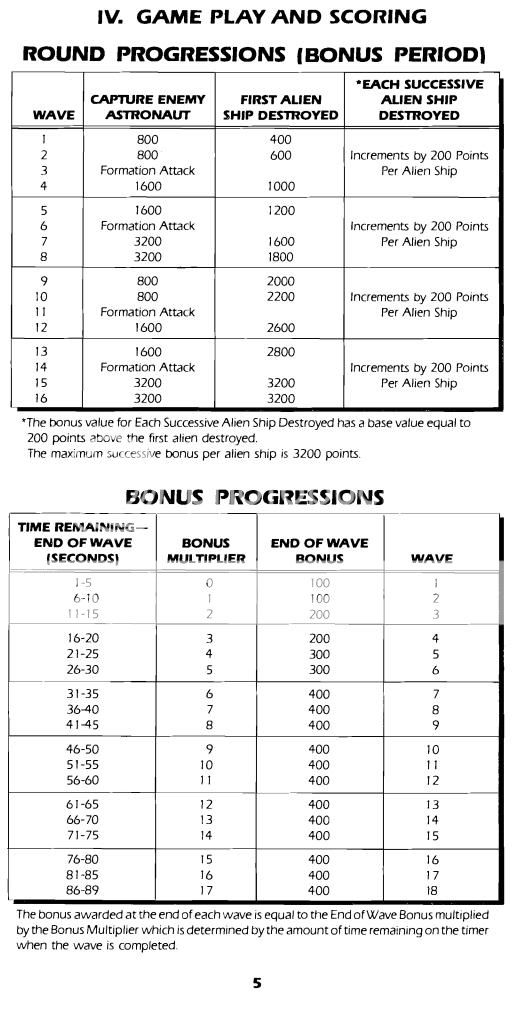

For those of you who own this game or play enough of it on MAME, do you happen to know the point value associated with the astronaut that flies in the blue pod? According to the screen shot, it's a mystery....
The first astronaut is 800 points. Maybe it gets progressively higher? I don't really know... never paid any attention to that. What really matters is the bonus period after picking up the astronaut.
dunno the value for the naut, but getting him activates the point multiplier for a short duration afterwards, which is the beauty of the game.

Do you have a camera and tripod? Step through your video frame by frame and watch your score. I used this technique to figure out some scoring on Hyper Sports swimming and Triple Jump.
Not sure if this helps - but here is the known scoring:
