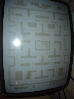

The patient (a K4906 with the mother of all Ms. Pac burn):

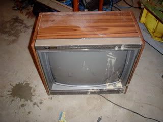

The donor (an old Zenith TV from the local transfer station):

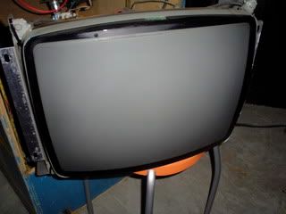

The monitor after the swap:
It fired right up! All the posts here about tube swaps and what type of TVs to look for really paid off--thanks to all who posted about tube swaps in the past.

Along with the lovely burn, this monitor needed convergence badly even before I swapped the tube. I don't think the convergence changed much, but like I said it was pretty far out to begin with.
This thing needs a cap kit too so I figured I would do that before getting too deep into the adjustments.

Here is a list of compatible Panasonic and JVC TVs and a couple others I snagged off another thread: (If you want to paraphrase this list, it basically lists all the Panasonic WT and CT series 19" TVs.)
