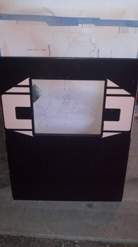

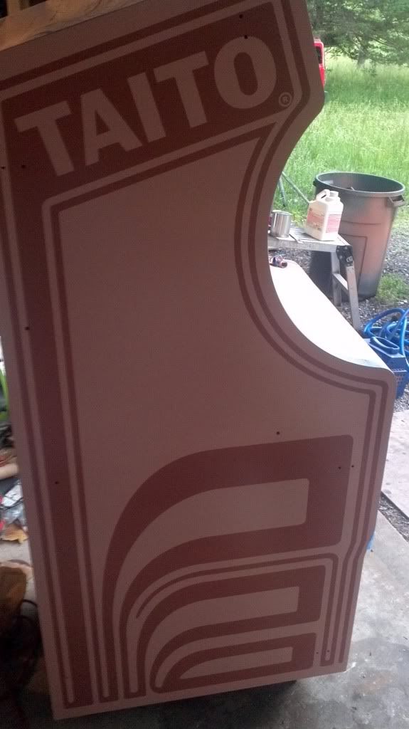

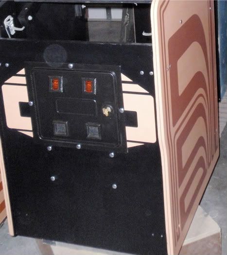

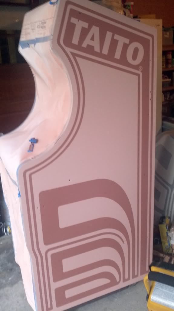

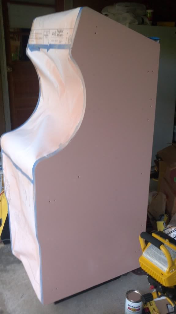

I used my vinyl cutter to make a coin door stencil and started to work on that. I had no color reference, so i kind of guessed from other pictures i have seen of EAs. In the end i borrowed a portable color analyzer from a local paint place and matched my colors to the marquee. Specifically the brown area, and the guys tanish coat. My paint guy recommended a Benjamin Moore DTM (direct to metal) paint. He said even though it was a paint made for metal, it would put on a very tough coat.
I thinned it down and sprayed on the coin door stencil area. All i can say is WOW!!! It sprays sooooooo much nicer then the rustoleum! It was easy to build up without running. It even covered the black in one coat and looks to be completely opaque. My only misgivings are that the color has a bit more pink to it then i envisioned. Hopefully that won't be so noticeable when i put the brown on.
Here are the pictures so far. For the before, just imagine the typical rough jungle king cab.
