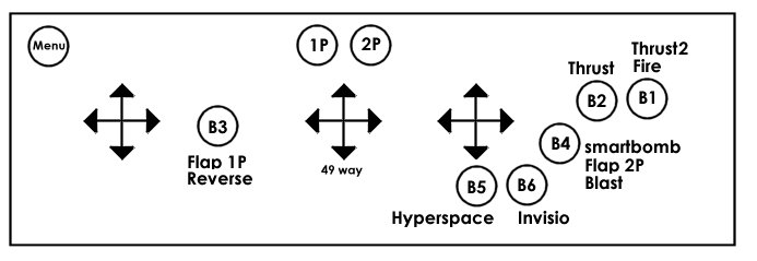

Since the last post in this thread, I haven't messed with this machine/problem til today. It's not like I have been fucking with this non-stop since I started this thread. I have a life to deal with too. I have had it in both modes, all wire outputs are labeled and in front of me. I currently have it in standard mode. I test all switches and they check out on the switch test screen. I go into game mode, I get no flapping (in either mode) unless I use the #1 buttons on both the player 1 and 2 sides. That's fine for Joust, but it fucks Defender's controls up. I am looking at the jrok pinout at the link I posted, and going by James' own pinout description, 3 and 4 on the player 1 side should work for both player 1 and player 2 flap and they simply don't in my case. Sorry if your Hyperactive, pop rocks-infused mind won't let you focus on any one problem for more than 2 seconds, but I'd rather fix this the right way rather than just throw it together and call it good cuz it *kinda* works.

Yeah, tried it, same thing. Interesting though in MW mode, player 1 button 1 works for flap in Joust AND Reverse in Defender. Isn't that what player 1 button 3 is supposed to do? Too bad the other buttons don't work right in Defender when it's set that way. If I go into standard mode, player 1 button 1 is still flap for Joust, but it becomes fire for Defender. This fucking blows. I was done with this cabinet nearly 2 months ago and still can't play it.
In the standard mode this is the button mapping I'm using. Without the 49-way though.
The menu button is entirely optional too, I'm using a defender panel.

James,Phet is saying that on his setup B1 is not mapping for fire button but rather the P1 flap and Reverse.
I think there has to be a board issue if that is what is happening.
The only other thing would be the wrong inputs are being used but Phet rechecked them.

Exactly right on all counts. No idea why, but B1 is doing B3's job. B4 does not work for player 2 flap, making me use player 2 B1, which isn't right for Defender. I suppose I can have two wires going to one button if I have to. Can I use the Defender input header for the Defender controls? Bipass the main harness, leaving it as is for the other games? Suppose I'd need a special mini harness for that and would still have to have more than 1 wire going to several buttons.

So.. in Defender, does B1 works as fire, B3 as reverse and B4 as smartbomb ?
You can always also wire Player 2 B1 to the flap 2 button as a last resort.
Get Joust into the test mode and do the button test. See which buttons it's actually seeing.

In MW mode, P1B1 is flap for Joust and Reverse for Defender/SG.
In Regular mode, P1B1 is flap for Joust and Fire for Defender/SG.
No matter what mode I am in, P1B1 is flap for Joust and it shouldn't be. P1B3 should be. The problem with this is that in MW mode, there is no fire button for Defender/Stargate. In regular mode, fire is where reverse should be. So either way, there is a problem. Looking at the 6 pin header, it only covers buttons 5 and 6, and those outputs/ buttons aren't the problem. This board needs to be looked at by you to see if it is mapped or programed wrong. Will you be able to test it and see if there is anything you can do if I ship it back? I have tried everything I can, and it isn't mapping correctly. The games all work, the menu seems to work, it's just a mapping issue with Joust.

They both show up as the right button in the switch test. When I press button 1, it shows as button 1 in test. When I push button 3, it shows as button 3 in test. When I put it in standard mode, button 1 'flaps' in Joust and 'Fires' in Defender (as it should). Button 3 does nothing in Joust, but in Defender, button 3 is reverse (as it should be). So in standard mode, the button mapping for Defender is correct, but then it's wrong in Joust.
What ROM and FPGA revision does it show in the setup screen ?
