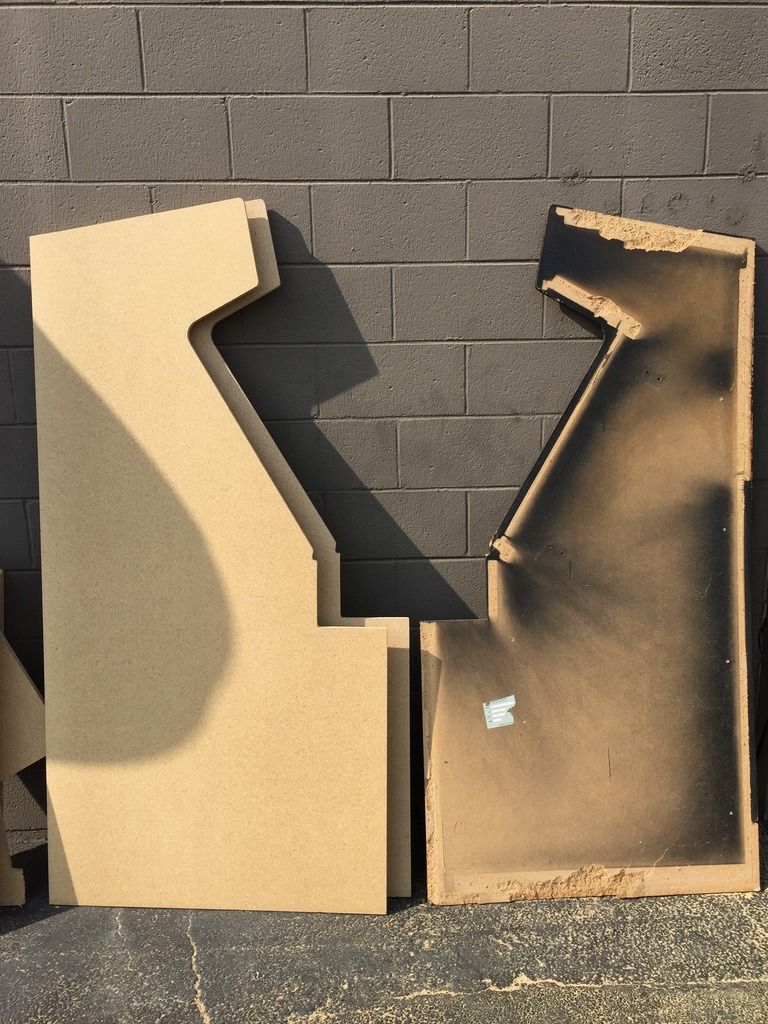

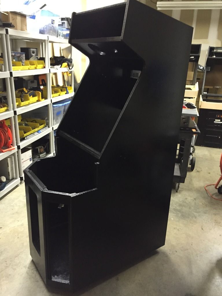

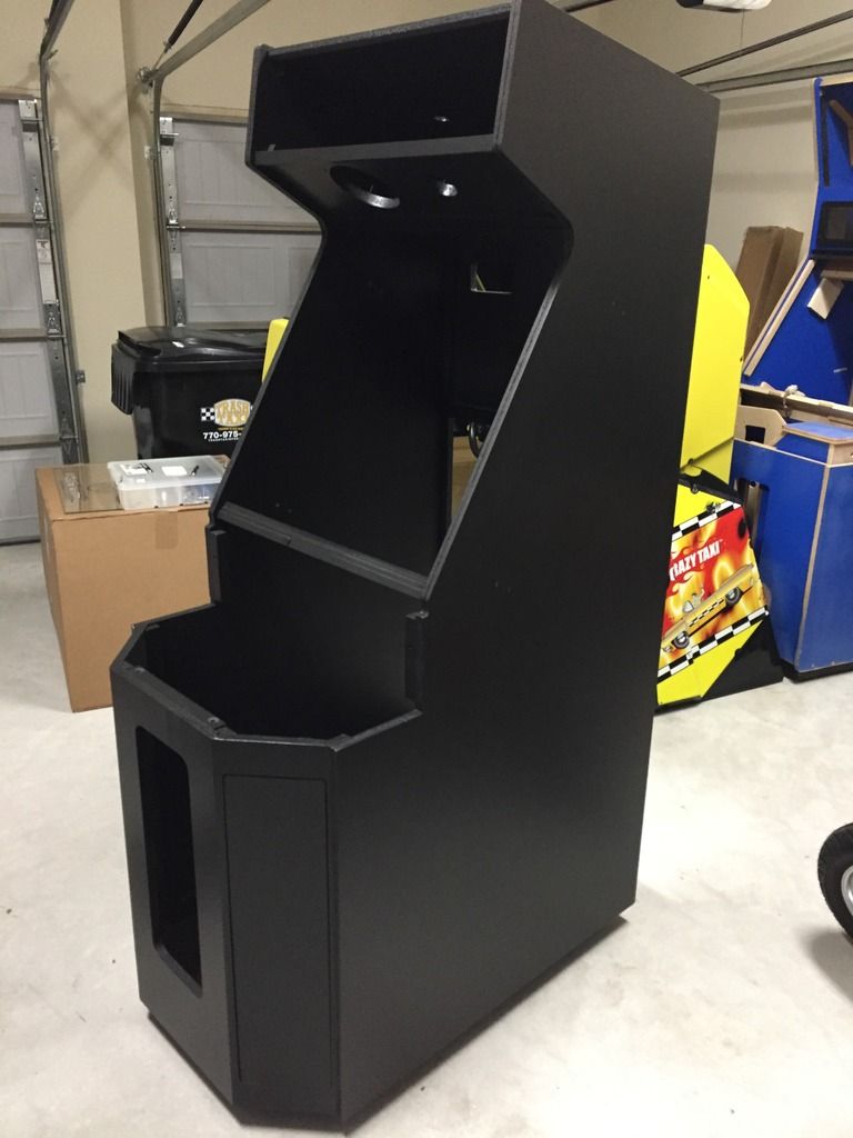

As you will see my approach to restores is not 100% authenticity as I do customize a bit... for me I prefer my cabinets to look as if they have just come off the assembly line but do my best to make sure I dont stray too far away from it's roots ... that being said, I dont know if I should call this MK a restore or a scratch build. I did start with an original MK that was converted to a Golden Tee '99 (no surprise there) ... side art had been painted over but the cabinet itself was trash with water damage, broken corners, busted back door and no shortage of rat droppings...

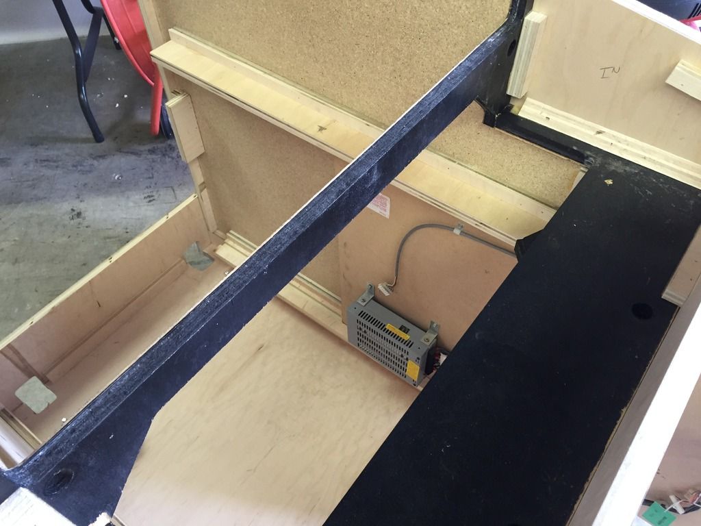

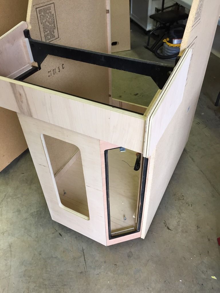

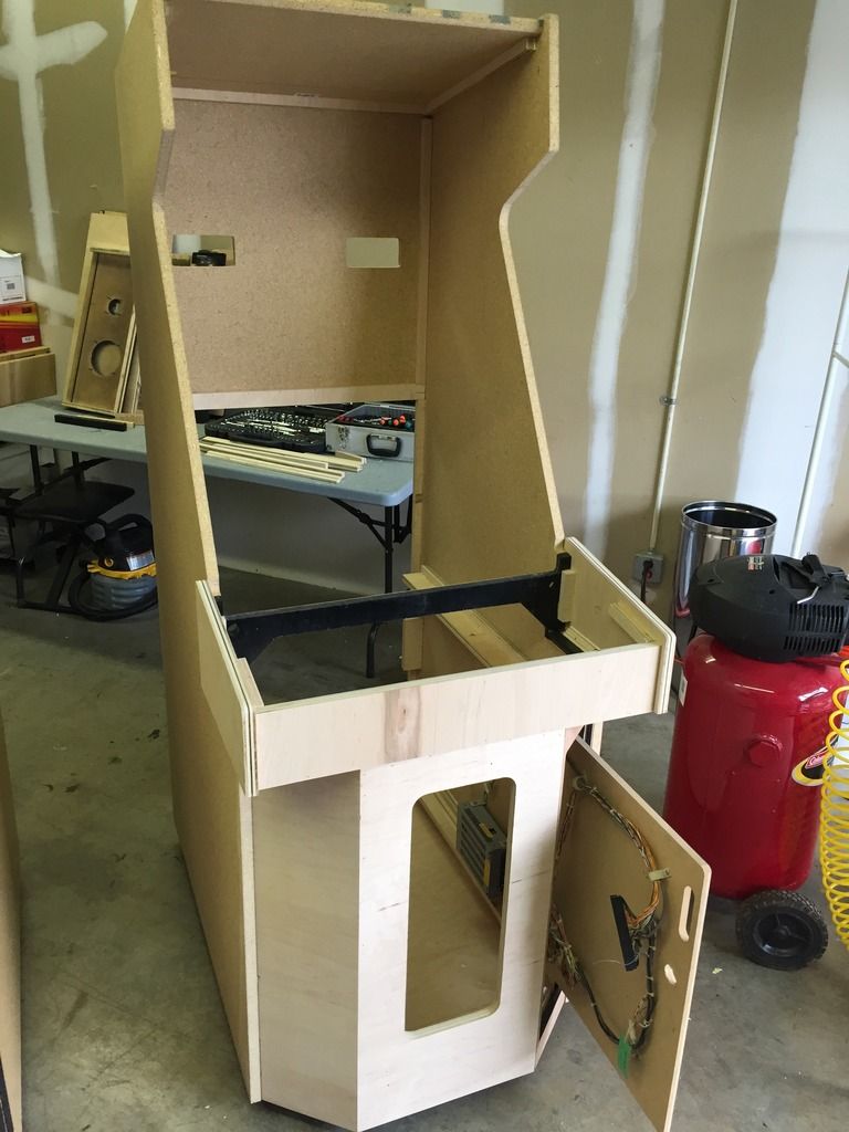

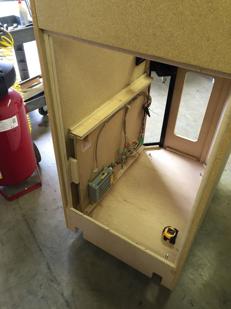

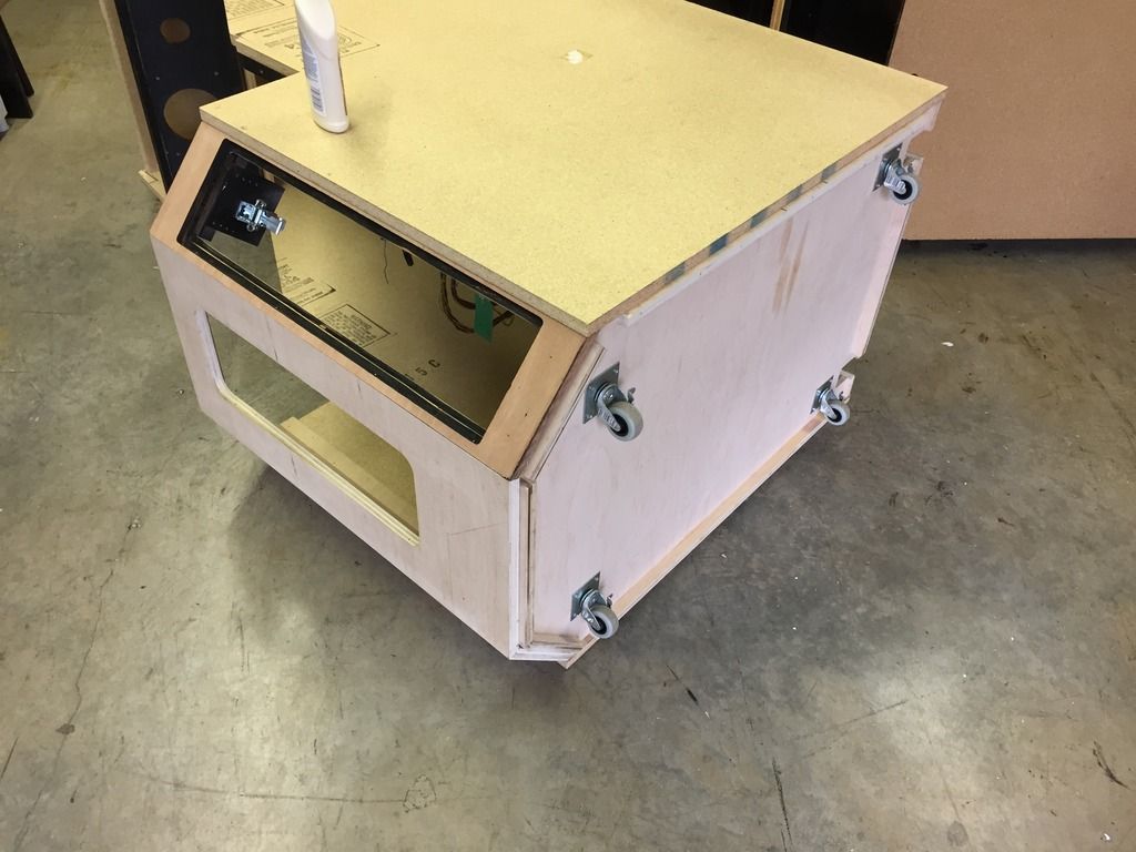

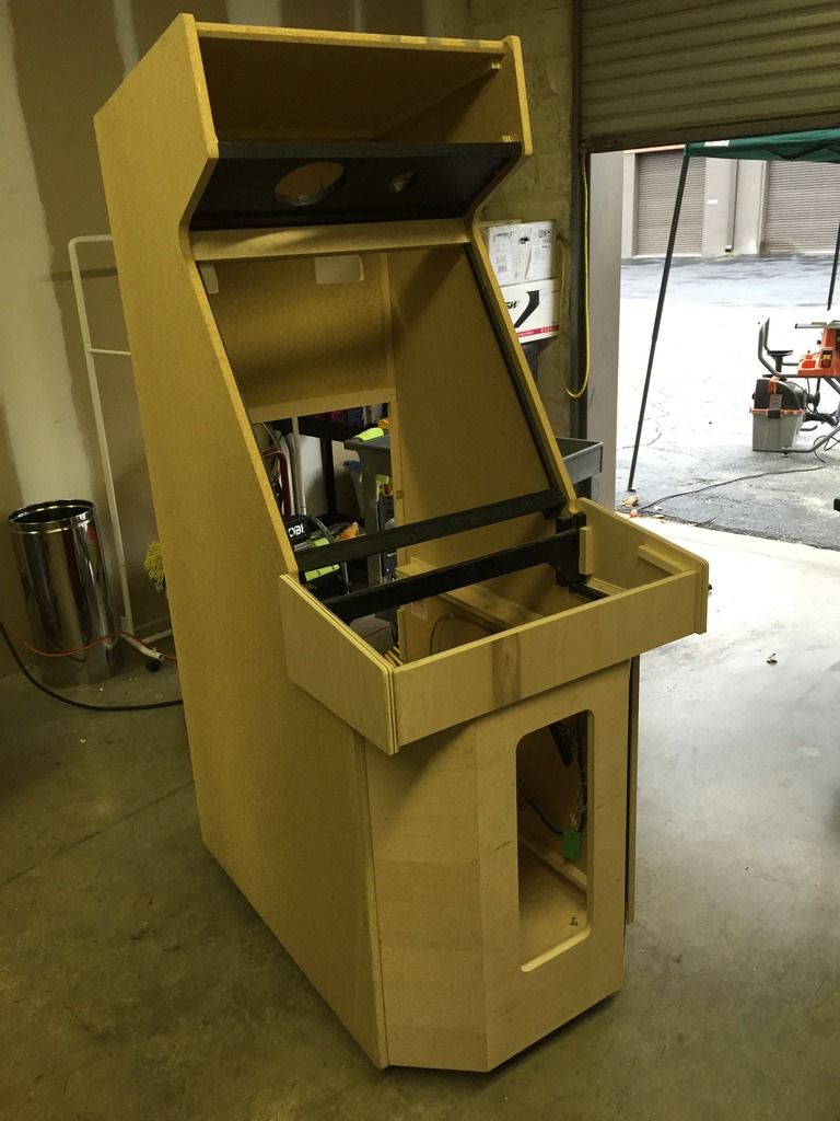

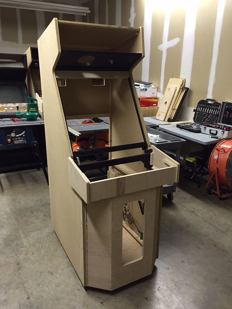

SO, i decided to scratch build most of the cabinet while salvaging a few pieces from the original (along with all the necessary hardware). I dissembled the original cabinet and used the original pieces as templates for new ones. All work was done with table saw and flush bit for router.

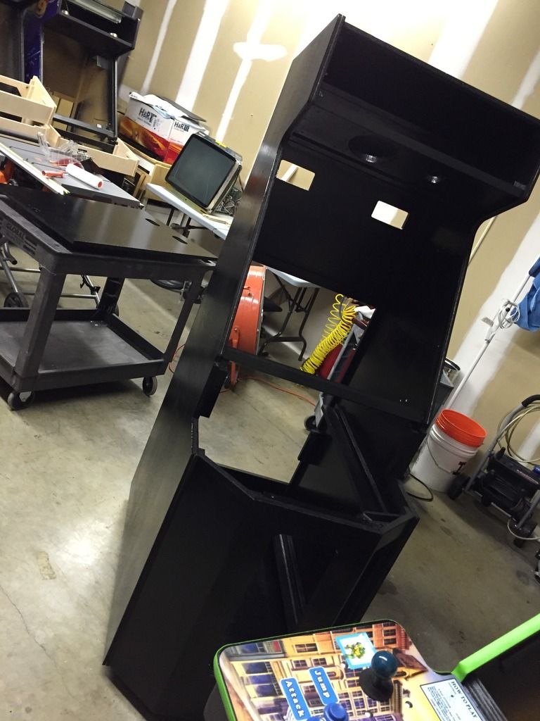

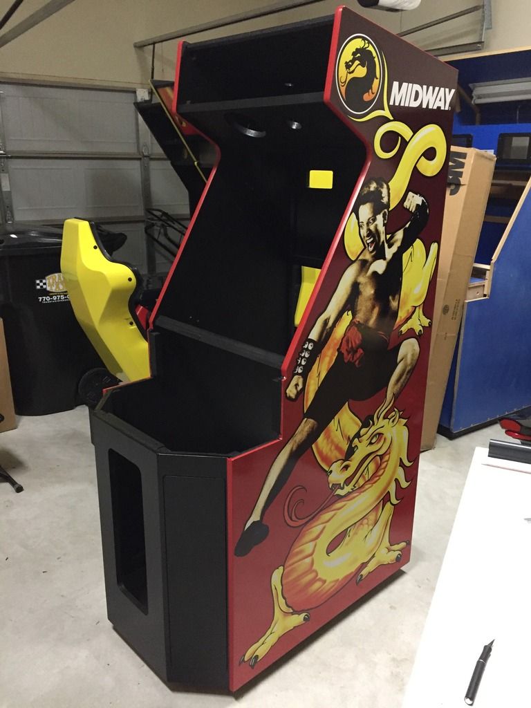

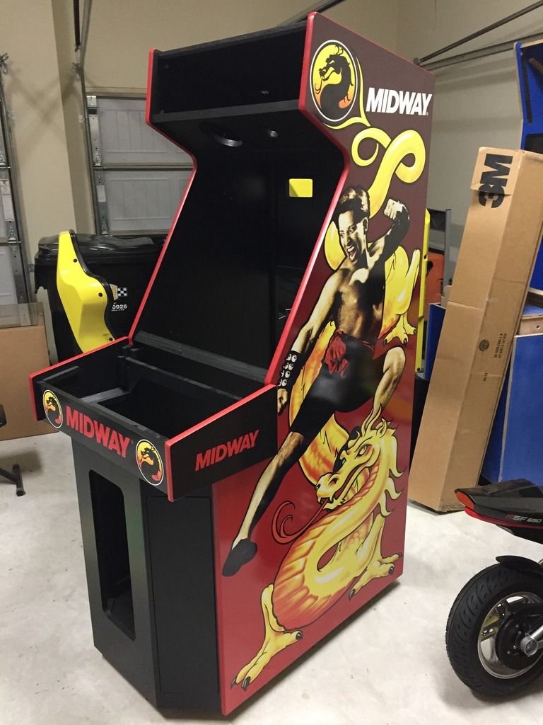

I cut new bottom, sides, top, control panel box, back door and 2/3rds of the front of the cabinet. Retaining the speaker panel, monitor bracket, back half of control box and the section of the front whihc the access door (thankfully as I was not looking forward to duplicating it) ... in one of the photos below you can see the new raw pieces married with the few original ones that are still black. After the cabinet was done I decided to paint it inside and out... I rolled it with black oil-based. for final assembly I wet sanded all of the areas that would get vinyl applied. The front of the cabinet is covered with 3M 1080 series satin black vinyl and the sides are printed on 3M vinyl.

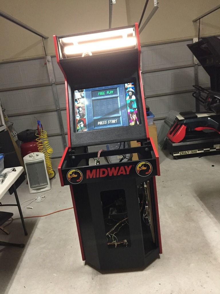

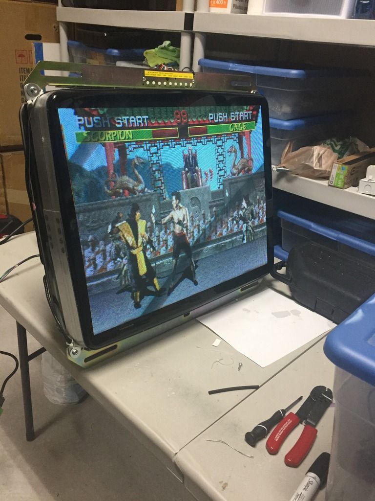

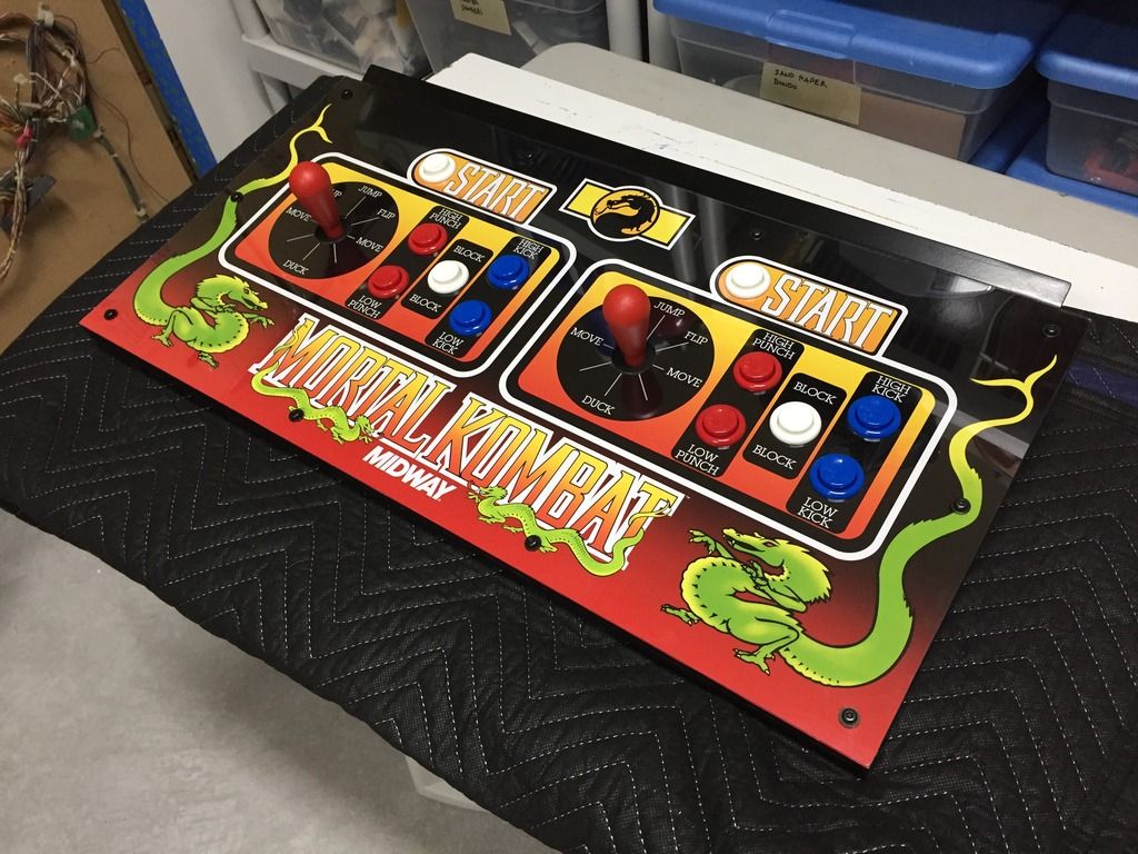

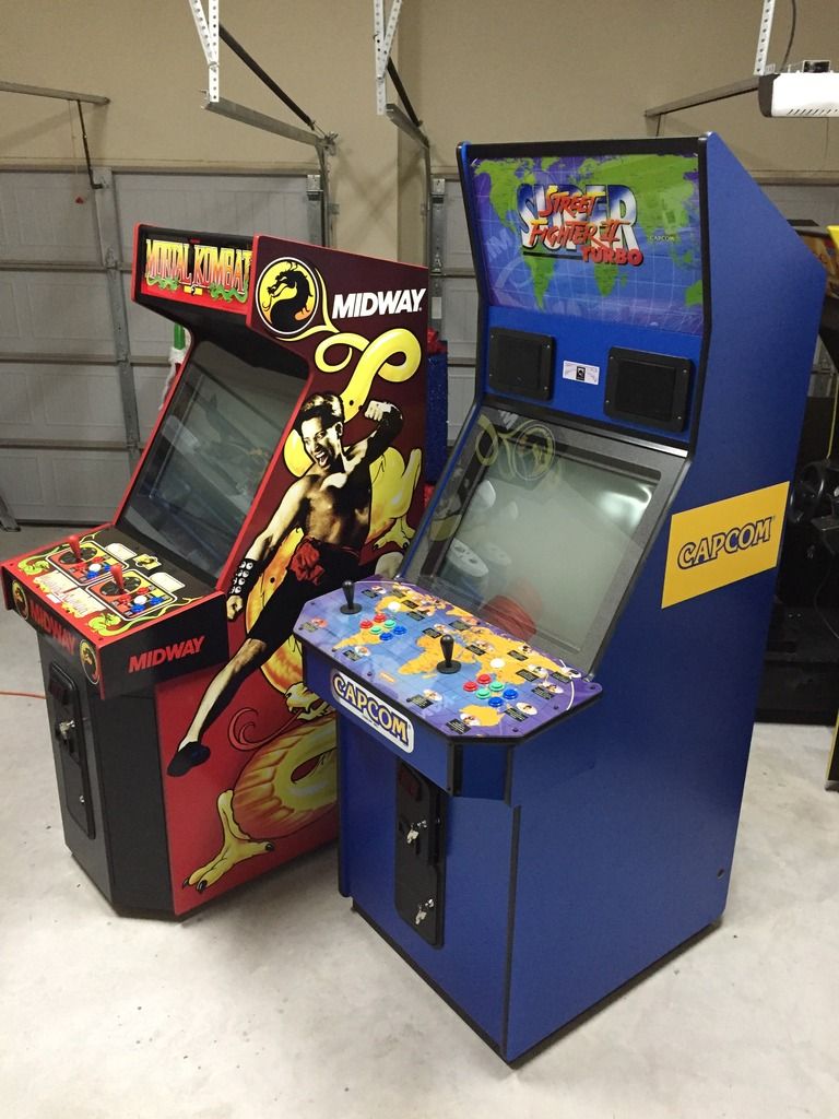

With all my restores, I have the metal re-finished (powder-coated), use all new buttons and joysticks (IL from Paradise Arcade) along with new plexi. new security screws, glass and new makvision 27" monitor shoe-horned in. Many do not Like the Makvisions but I have never had an issue and they look fabulous in person. I also like the idea of a brand new monitor although I have heard stories of the Makvisions being DOA ... I have a couple extra in case but so far no issues, knock on wood.
A new journey for me on this was rebuilding ALL of the artwork from SCRATCH and having it printed here locally. MK is one of my all time favorites (second only to Killer Instinct) so I wanted to have an artwork package that was worthy of the time and energy that this project was going to consume. After ordering a set early on (forget where from) I realized that I was not going to be happy with what was out there so rebuilt it. I had help from a fellow KLOV'er who provided me the original scan of what is probably the basis for most artwork that is currently out there. The ONLY thing I retained from that was Johnny Cage live action picture which was already great quality. Every other component, dragons, MK logos etc we all rebuilt with vector paths and composited in Photoshop. I originally reproduced with halftones to match (as closely as possible) the original artwork... However, for my own prints I omitted the half tones and preferred the nice clean gradients. I finished the print ready art both ways and will be updating this thread with links to share once I organize and package everything up. UPDATE: here is link to thread containing artwork download https://forums.arcade-museum.com/showthread.php?p=3522772#post3522772
