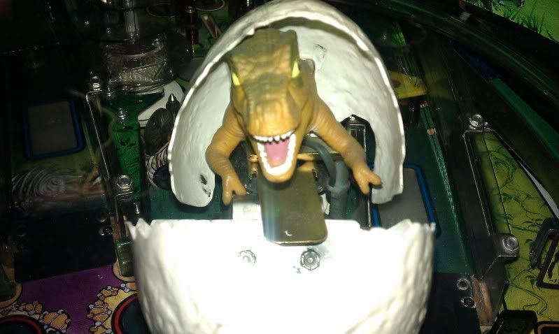

The Hummer pic up is having issues. It stops the ball fine, and picks it up, but once it gets to nearly vertical, the ball falls out. Is there and adjustment or something I need to look at?

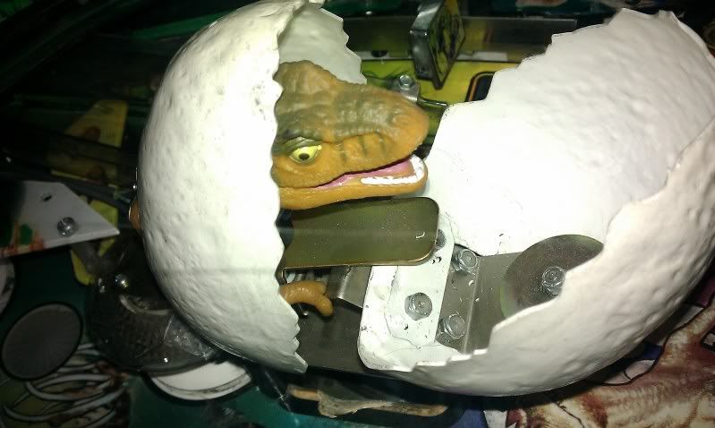

Also, my egg was working 100% when I played it at the sellers house, but once I got it home, it started having issues. The T-rex's right hand gets caught under the front of the egg when it opens, and then it has a hard time closing afterwards.
Thanks for your help.
The metal bracket looks like it might have a stress crack in it. This might have bent and is one reason the hand is getting caught. You might also just be able to loosen a few screws and move the dino over a bit if possible.

The line in the first pic isn't a stress crack, it's just where the two metal plates rub together. I'll try to move him over.

Update, it's now working 100% except for a few burnt out bulbs. Here's what I did:
For the Hummer, I just shifted the wires around a bit at the base of the snagger (where they bend the most) and that solved the problem. I'm sure at some point it will start happening again, but for now it works (plus I know what the problem is)
For the egg, I cleaned the sliding surfaces between the T-rex base and the front of the egg. I also adjusted the T-rex's alignment (with the slotted mounting screw on the right) so that is doesn't get caught anymore.
