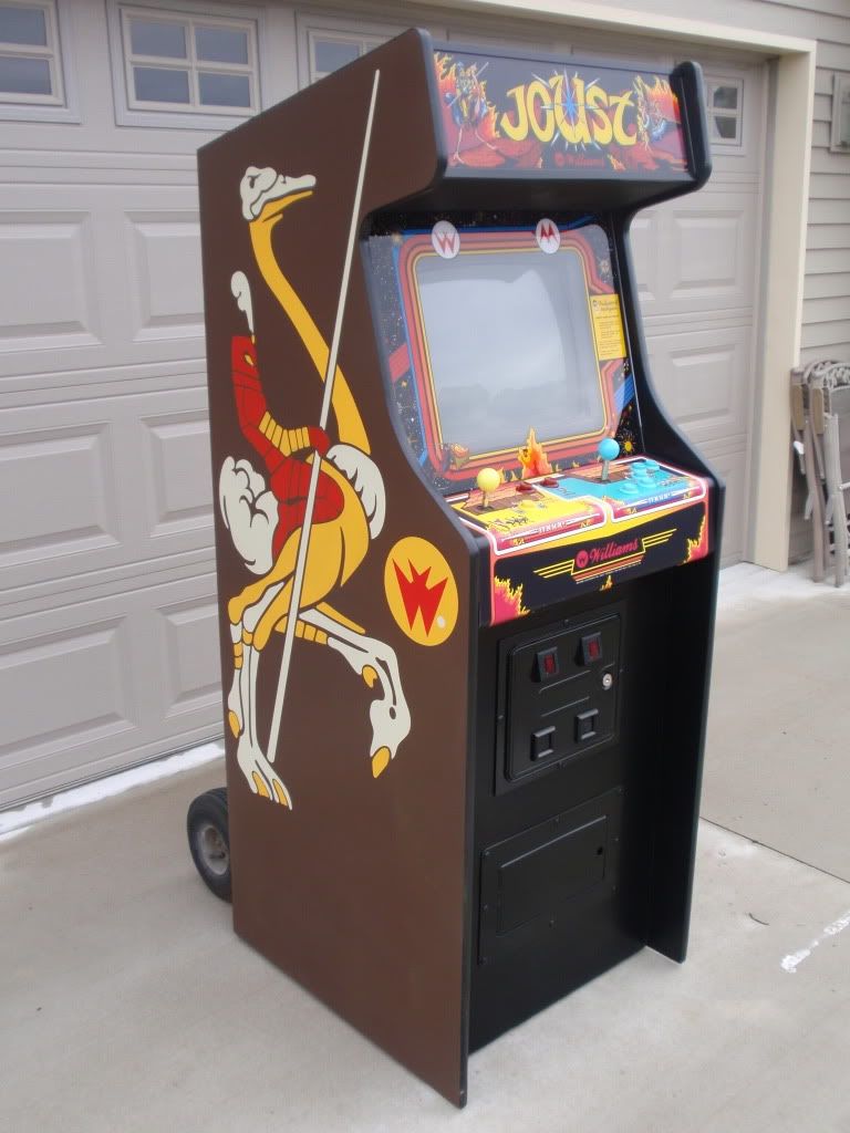

I used an HVLP set-up and sprayed mine with Sherwin Williams All-surface Enamel for the base coat then sprayed my stencil coats with Rustoleum oil-based colors out of rattle cans:
No kidding..your cabinet makes me want to restencil a Joust and consider getting rid of my cocktail Joust.

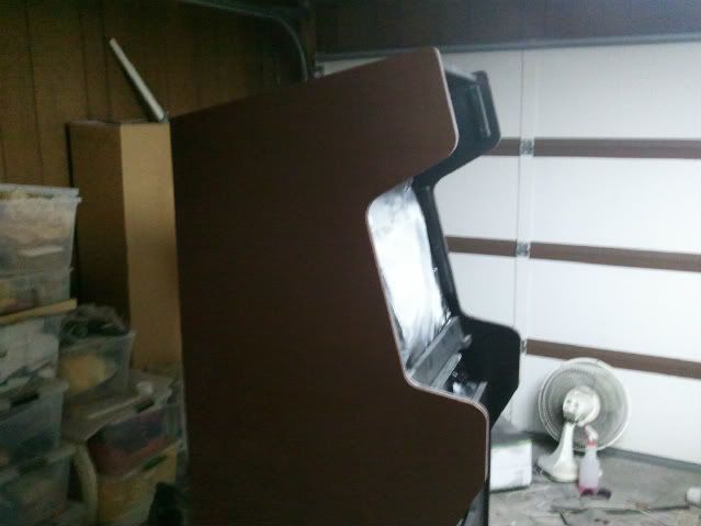

Rolling this latex is driving me crazy. Its friggin impossible to get a consistent finish which is really surprising. Im using a foam roller and after the coat is dry theres always some kind of imperfection. So I sand in between coats with 400grit paper and wipe down the side put another coat on and another problem after then next coat. I wouldnt do another one of these without a gun. Its like some areas are more glossy than others. Ive got like 7 coats on each side now probably lol. Im done though its looking good enough I guess.
I got some spray paint colors that arent going to be an exact match. I couldn't find anything that matched the yellow/orange color in the art. It was either straight Orange or Yellow. Ugh again not doing this again without a gun. Hopefully the stencil and art comes tomorrow!
Ok so im not done after all. One side you can clearly see where the roller has been. I just don't understand. Im thinking about getting a brush tomorrow because at least the marks would be more consistent and probably less visible. Maybe I should thin the latex with something?

I've gotten really nice finishes with latex before. I use a 9 inch micro-foam roller. I will get a slight orange peel effect, but not really roller marks. It is kind of an art, I suppose. Next time, roll on oil-based paint- it's much easier to roll and finishes very flat. Or... spray :)
As bad as rolling might be working for you, I really think brushing will be a LOT more uneven. I'd try some Floetrol with a foam roller. Too bad if you can't spray right now, but as much trouble as spraying might seem, instead of multiple rolled coats, let dry, sand in between, days of work.. with spraying you can spray a whole side in a minute, let dry 10 or 15min between coats and spray a whole cabinet color in under an 45min. It's just so quick.

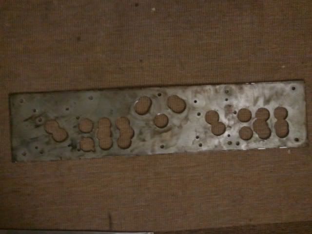

I didnt know there was a turbine hvlp. Looks cheap and sounds great too! Oh well next time. The Floetrol and the roller produced passable results so im calling it quits on painting. Heres my new control panel.
Just kidding. Looks like someone should have measured a few more times before putting 100 holes into that metal lol. Heres the wood free of goo and also hacked up quite a bit.
I got a piece of 6x24 sheet metal to replace the swiss cheese CP and cut it to size so just need to add some holes, hopefully not as many as who ever made that :) One question though when your applying the CP art how forgiving is the adhesive if you make a mistake? Is it easy to lift off if you screw up a bit in the beginning?

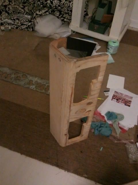

You might want to consider buying a new control panel with a little more wood on it. Just putting a new piece of metal on that will not be enough. The Williams 2 way joysticks are designed to fit into a slot in the wood so they don't wiggle.
Also the wooden top is set up to take t-nuts flush with the top surface of the wood. The overlay goes right over them and the bolts attach from below. If you are going to use top mounted bolts to hold the joysticks down, the bolt heads will stick up on the control panel top and your knuckles will definitely not thank you.
The adhesive on most CPOs is not at all forgiving. It is stick once. The other problem is the polycarbonate laminate on the top does not take much bending without fracturing so trying to pull a CPO off if you make a mistake is almost impossible without messing up the polycarbonate.
When I do a CPO I pull about a 2" piece of the release paper back on the top edge. I line the sides up and press the top to the control panel and then clamp it with 3 or 4 of spring clamps. Then I slowly peel the release paper off a couple inches at a time, pressing it down as I go. Just take your time and don't rush it. Pay particular attention as you go around the corners. If you let the overlay get away from you on the corners, you will end up with sharp edges that will crack.
