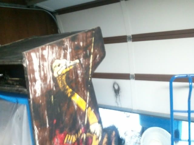

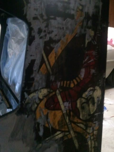

Did some stuff on my day off.
Wish I would have given this stripper a shot before i sanded through the other side. I think if I was careful enough I could have easily brought back the original side art.
I thought putting the casters on would keep the bottom edges off the ground and the bondo safe. I dunno how I will ever level it though. Hopefully I can get more finished tomorrow :)
I see what you mean. But taking your time and doing it from scratch is going to make this restoration project that much more fun. Being patient and not cutting corners is the key. The feeling you will get once you start stenciling the side art will probably be priceless. There are a few outstanding joust threads here. I would love to restore a joust cab just to do it.

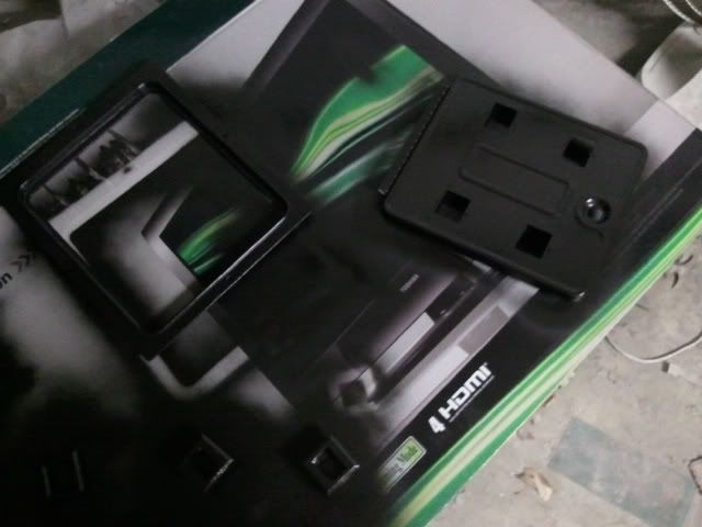

Im using the Rustoleum satin black spray cans on the front and im not to happy with the paint. I kinda screwed up I guess but I let it dry for 4hrs thinking it was going to be ready for some sanding but it wasnt even close to dry. Im having to wait overnight before I touch it. I dunno if its the humidity or what but that seems kinda weird. For the coin door Im using Rusoleum hammer finish and that stuff is awesome. It came out perfect and was dry to the touch in no time. Heres the current state:

Is it possible that the satin black was old? I've had a few cans of rustoleum that wouldn't dry. The only thing i could figure out, is it was a either a bad batch, or old.
I bought them from Home Depot so I couldn't imagine that they are that old. I got it finished just took a few days :)
