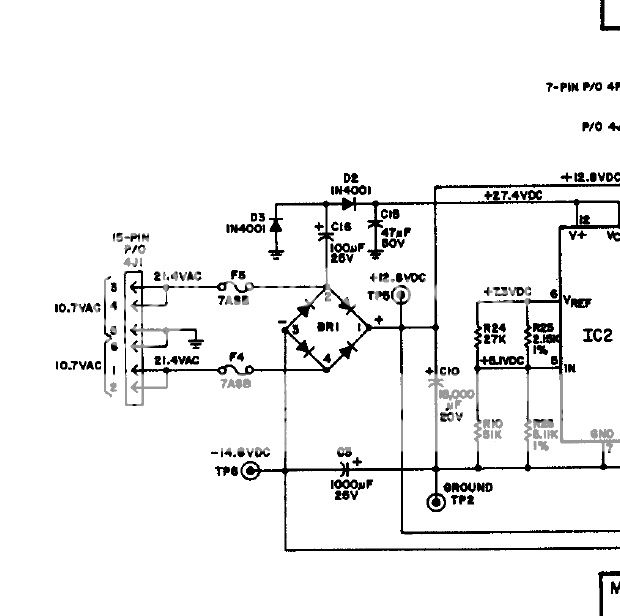

Bought this game broken. The +5V led was out on the power supply board so I bought and installed the Bob Roberts repair kit. +5V led is still out. Probing deeper if I disconnect the power line to the ROM board (? The one with the alphanumeric output on it) the +5V led illuminates. With the ROM board connected the +5V line reads at +1V.
Does this mean a short on the ROM board is likely? Or the PSU can't supply the load the ROM board needs?
Ideas? :)

Ok, KLOV help me out, I don't know much about this analog stuff... Should I be able to test the bridge rectifier in circuit with a DMM?
On the part BR1, pin 3 to 4 tests good (diode setting on DMM). Pin 3 to 2 tests good.
Pin 2 to 1 shows open circuit (as does 2 to 1 direction).
Pin 4 to 1 shows open circuit (as does 1 to 4)
Pin 3 to 1 also shows open circuit (as you'd expect if 2/1 and 4/1 are bad right?)
D2 & D3 also test good.
Can I conclude the BR1 part is bad? Do you carry this security0001?
Thanks!
yes i carry ALL the bridge rectifiers 35a1000v with wire leads for newer p/s and the spade terminal for the older p/s.
tendril BR1 sounds kinda pooched to me from what you are describing but... LOL!!! a bridge rectifier is just a bunch of diodes and we usually have to test those out of circuit. i would lift leg 1,2,4 to test just to rule it out, if its done it has to come out anyway. what did 3 to 2 test? that looks like it feeds to C16 to D2 to the 27.4vdc into pin 11 & 12 of the vreg IC2, and out on pin 3 of IC2. check for +5 on pin 3 . after IC2 the only other stuff i can see on the schematic that could possibly effect +5 maybe if C4,C5,C7 , Q1,Q4 or zener ZR1 had short to ground, and you already ruled out 6057 .

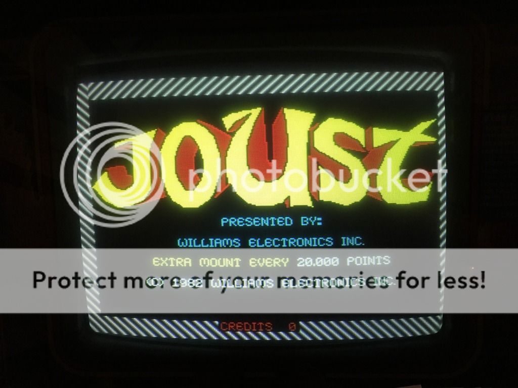

Thanks to security001 for some fast shipping! Parts arrived Saturday afternoon, new BR and I got the big cap too as shipping was the same. +5V restored when under load. Futzed with the board inter-connects a bit to get it to boot, replaced 1 RAM chip reported bad by the self test and it works 100%! Seller told me it had been home use since late 80's and a board had gone bad around 2001 and it hadn't been turned on since. I had a cap kit for the monitor ready to go too but in fact it was damn near perfect as it was. (Photo taken before a slight horiz pos adjustment to center up those title screen bars :))
