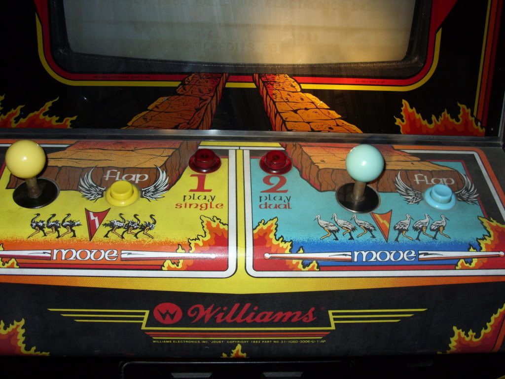

How many Joust's Came with optical joysticks. I just started working on my 2 joust's. I noticed something looked weird. Joysticks on one looks alot bigger than the other, talked to Dokert and found out they are factory optical Joysticks.
Machine should be running tomorrow, I hope:D
How rare are these sticks, How do the compare to regular Joust Sticks?

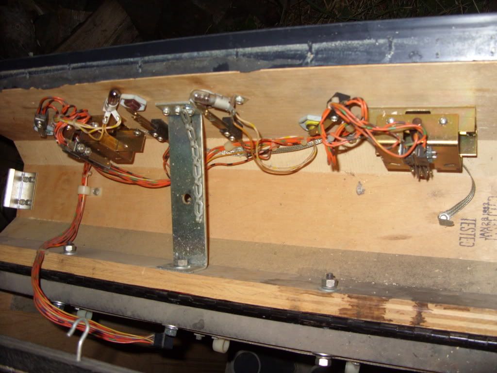

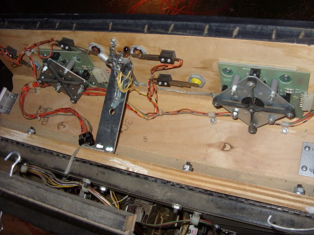

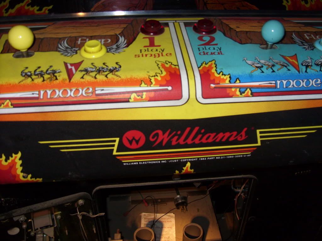

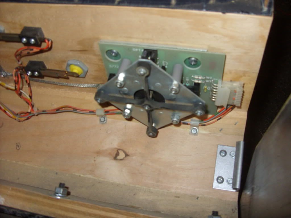

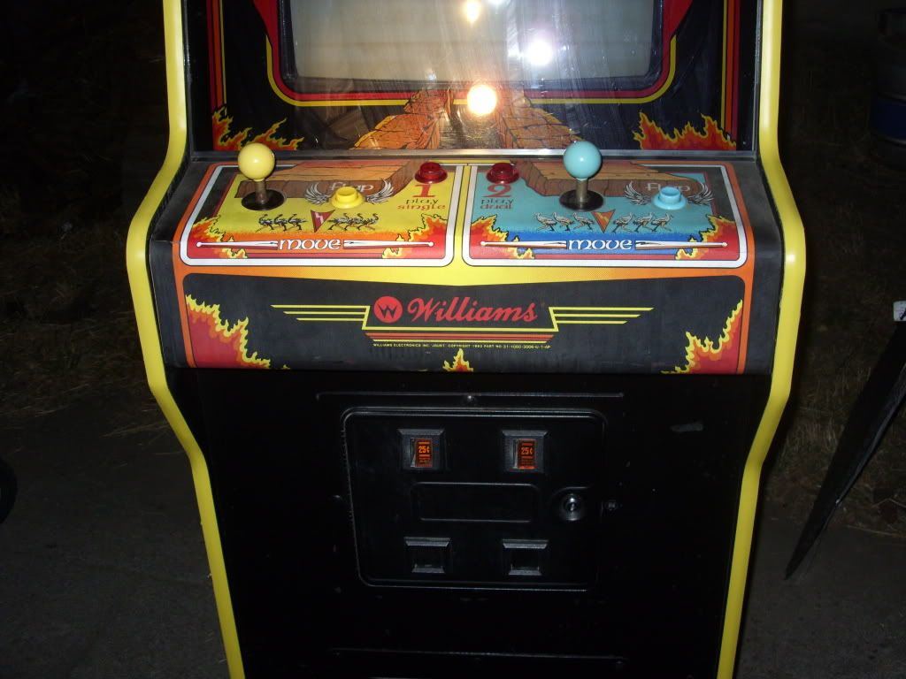

Here are some pictures of the optical Joust panel. The Sticks are way taller than a normal joust!! The control panel overlay part number is different, and text is in yellow not white like a regular joust panel. Now I think the yellow Tmold might be original, it matchs the yellow on the cpo parts number??

The Opticals also appear to use the same centering spider as Sinistar joysticks.

If you look at the stock number on the CPO, the optical stick one has a -1 after the 3006, which would make me think it's a revision of the other one (why would you put a -1 on the first one, but no number on a revision?)

The part number difference is for the round holes (for the optical sticks) vs the oval holes for the mechanical joysticks. My optical Joust was a rebuild so the serial numbers don't mean anything. I have seen 2 optical Jousts on Ebay total. There is one on there now. It has the Willis CPO.
