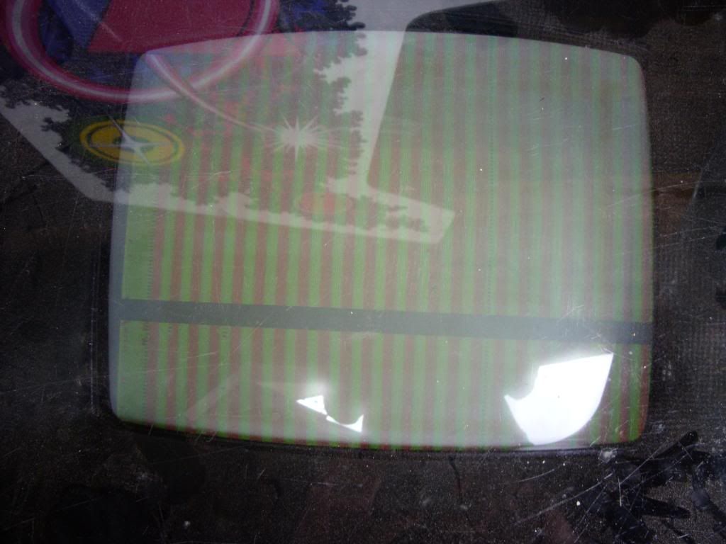

I plugged it in and tried a few times to get it to boot, this is all I get for now. Im burned out from the Show, so I wont touch this for a few days.

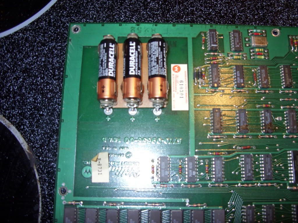

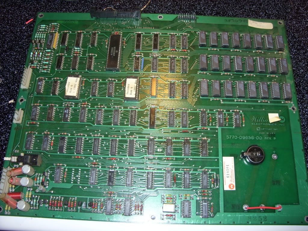

Installed new batteries but the machine would only boot into setup. So I replaced the battery holder with Bob Roberts Williams Battery mod. Works awesome now boots into game and holds settings.
