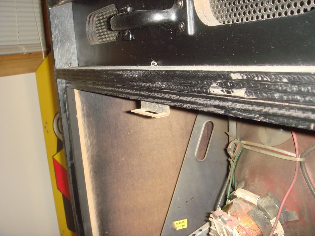

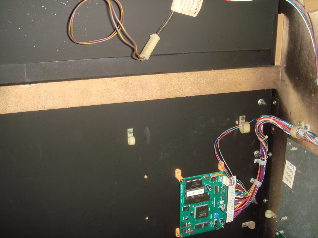

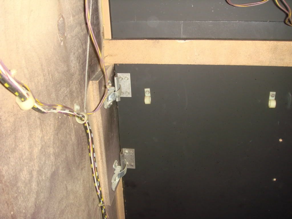

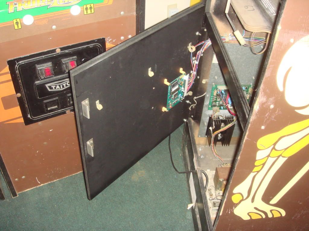

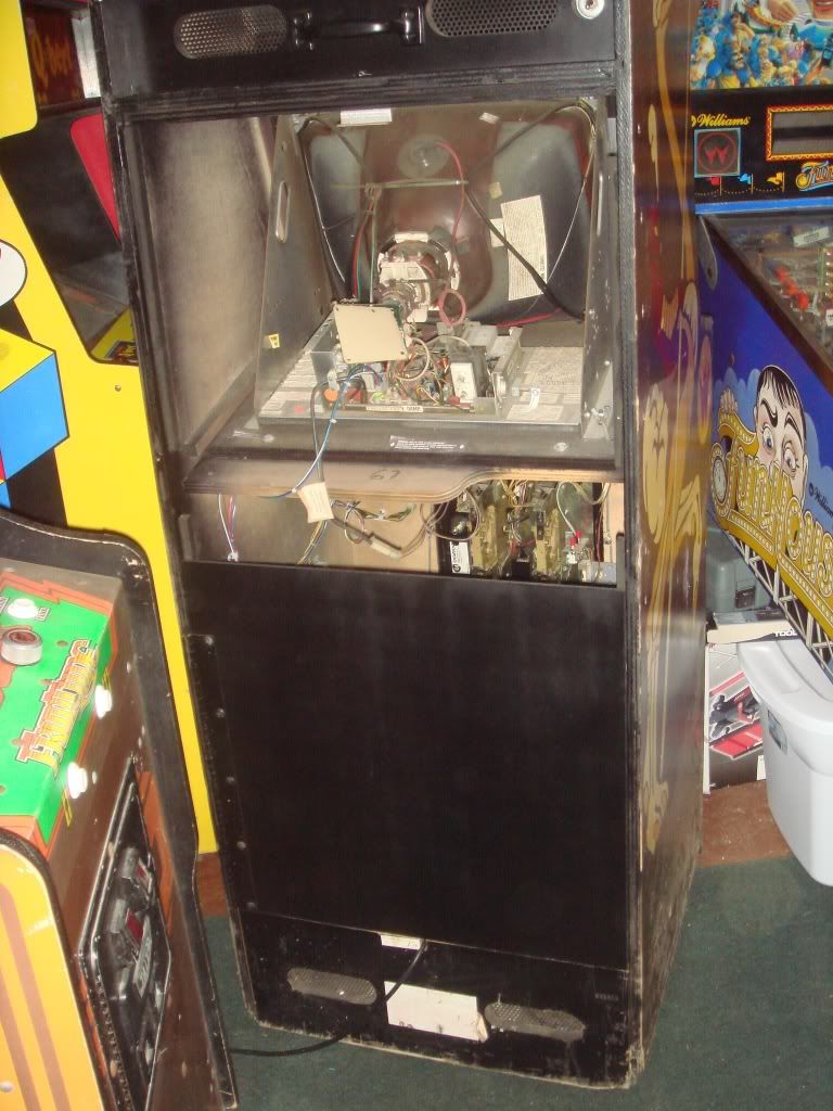

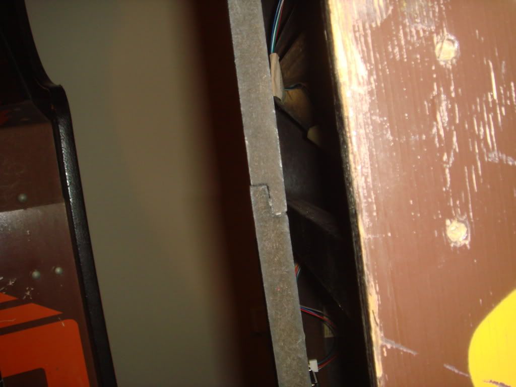

By request, backdoor pictures and details.
This was a home-made door, so measurements may not match exact to original (concept is the same).
JROK Multi-Williams PCB. More detail on this machine here: http://forums.arcade-museum.com/showthread.php?t=117871
TOP DOOR
- 24 3/8" wide
- 24" tall
- 1/2" thick MDF
- Lock is centered side to side, 2 1/4" from the top.
Bottom Door
- 24 3/8" wide
- 23.5" tall
- 1/2" thick MDF
