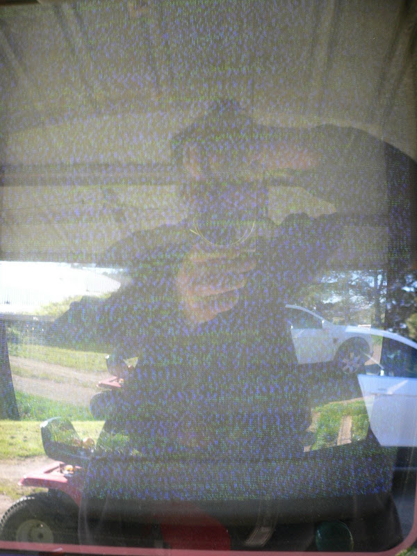

when i first fired up the machine, the machine booted up, and showed the rom test screen (see below - this is superullys joust2 rom test screen pic).
and my joust2 stepped through each rom and each rom was shown as ok.
the next step in bootup was the rug test screen (pic to follow)
here is where the work needed really starts. the rug test would repeat itself ad nauseum, occasionally it would display 90% of the following text screen but would always reboot itself etc etc.

Crap. display now shows horizontal bars about a 1/4" white dark white etc. but even a bad symptom can be useful information.
At this point i re-checked the Power supply voltages. the 5v rail and -5v rails were off spec at the pcb.

i know - PICS or it didnt happen !
rug test http://lh3.ggpht.com/_C8QfKbqwCA4/TKe6zPU_u5I/AAAAAAAAA-M/9FU7uqusNNI/s800/P1040605.JPG
rom test (completed) http://lh4.ggpht.com/_C8QfKbqwCA4/TKe66LWcxEI/AAAAAAAAA-c/5VmHQ0vjXpY/s144/P1040607.JPG
all systems go! http://lh4.ggpht.com/_C8QfKbqwCA4/TKe69Zn3w9I/AAAAAAAAA-0/uNthN3Dg-DI/s144/P1040608.JPG
Hiscore screen (this may be familiar to someone - be assured it has a good home with some familiar company - many thanks! :)) http://lh3.ggpht.com/_C8QfKbqwCA4/TKe6_zt8Y6I/AAAAAAAAA-8/xTzvwukcZSs/s144/P1040609.JPG
title screen http://lh5.ggpht.com/_C8QfKbqwCA4/TKe7KP695cI/AAAAAAAAA_w/FlUKeyzX6Co/s144/P1040614.JPG
prepare to joust http://lh6.ggpht.com/_C8QfKbqwCA4/TKe7O_yLd0I/AAAAAAAABAI/5CrHtylFPYg/s144/P1040616.JPG
game freezes at this point - still have some work to do yet.
