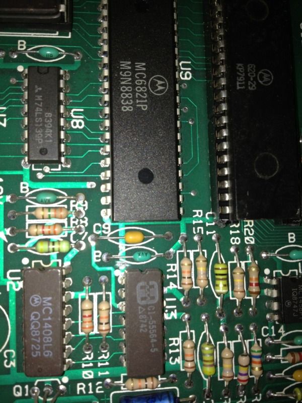

I burned the updated roms but have not done the mod on the board yet, I need to check what exactly it is doing to the circuit because the directions are not 100% clear.

The directions for the sound mod in the service bulletin are a little hard to follow but once you have the board out and locate U3, it's easy to see.
The sketch in the bulletin resembles the actual traces on the board. I will draw up a new image this afternoon.
Took me about 5 mins to do.

Well this took longer than I thought....:) I *THINK* I got everything labeled correctly. I take no responsibility if you damage your board. Please look over the original service bulletin and compare diagrams. Be careful not to create any shorts from cap or resistor legs. I used a 10uf 50v cap and a 1K ohm 1/2 watt resistor as that is what I had on hand. Hope this helps. :)
