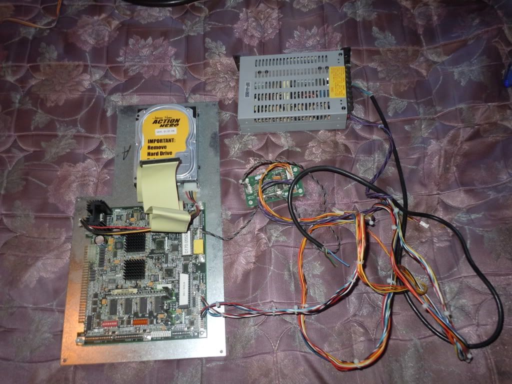

Board set arrived non working. Nothing but a white screen displays. Tossed it in 2 working jamma cabs and they both did the same thing.I bought this kit to toss in a cab on location and cant use it now. Total bummer !!
I even disconnected the hard drive from the board set still came up with nothing. no sound either
Cbass I have not heard back from you- What happened ?? :confused:
The pcb for is very sensitive to voltage. Lower the voltage slowly and tell us what the red lights do. There 3 on the pcb near the cpu. One solid or intermittent flashing means issues. Three flashing means its booting. Also pcb needs-5 volts. Hope this helps somewhat
Those are the power leds. Those should always be on solid. Look near the pic chip. Its the chip with the small label on it.
The pcb does not work if over powered and actually needs to be underpowered. One other thing about these pcbs they need a working hd to boot.
all 3 LED's are solid when I apply power and stay solid. -5v is wired also

ok - I just replaced the switched power supply and zeroed it in just under 5v. Game does boots up only if the hard drive is disconnected. Once I plug the hard drive back in the screen goes white, so the hard drive is toast. It did boot to the credit menu one time. Good thing is that I have tons of hard drives just dont know how to copy the data to the other drive. I own a hardware hard drive cloner but since the drive dont properly I cant use it. Anyone know where to get the data from?
Thanks for all the assistance as I was not aware how voltage sensitive these boards really are.
IT has to be in a chd format and u have to use chdman program right? I was just looking it up on the web. Thanks for the help
