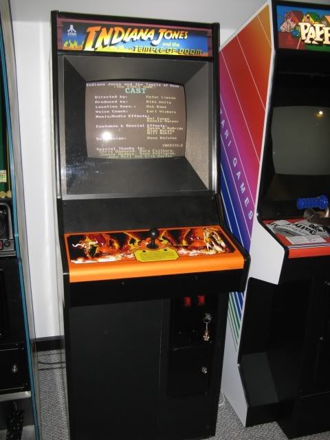

Howdy Folks!
So, I got bored and decided to restore the game that got me into this hobby…Indiana Jones and the Temple of Doom! I forget when I actually picked this up…I think it was about 3 years ago this past summer. I was a total noob to the hobby and bought it off eBay and had it shipped out from California. I think I paid around $450 for it, which wasn't too bad, but of course the shipping kills you. Months later I joined here and stumbled across some posts by ENDOFLINE (IIRC) with some pics of his games and recognized his garage from them…turns out he's the one who sold it to me!

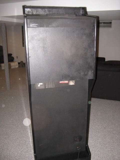

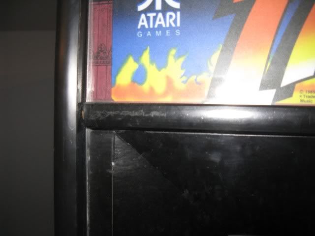

So, the game was in decent condition. It had new vinyl on it, but it wasn't up to Jedidentist standards:

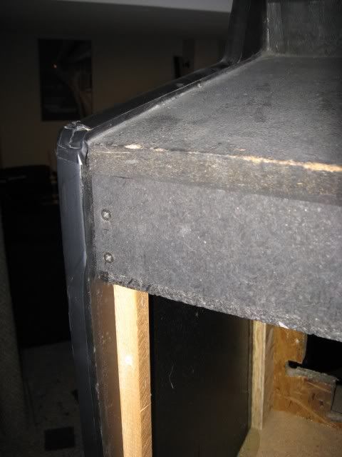

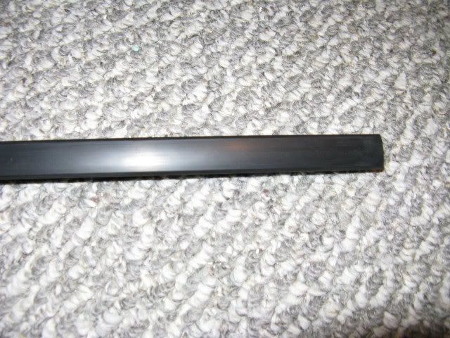

A lot of the vinyl was installed and covered over the broken t-molding:

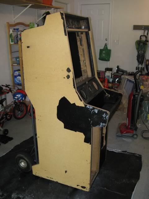

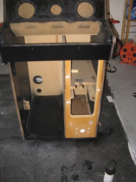

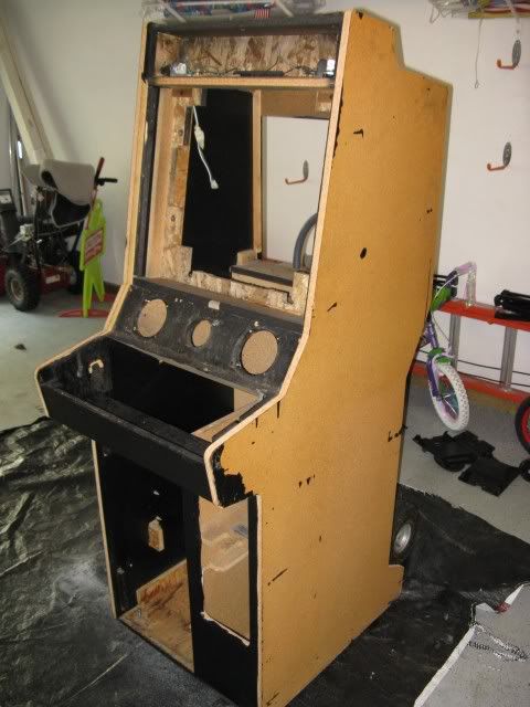

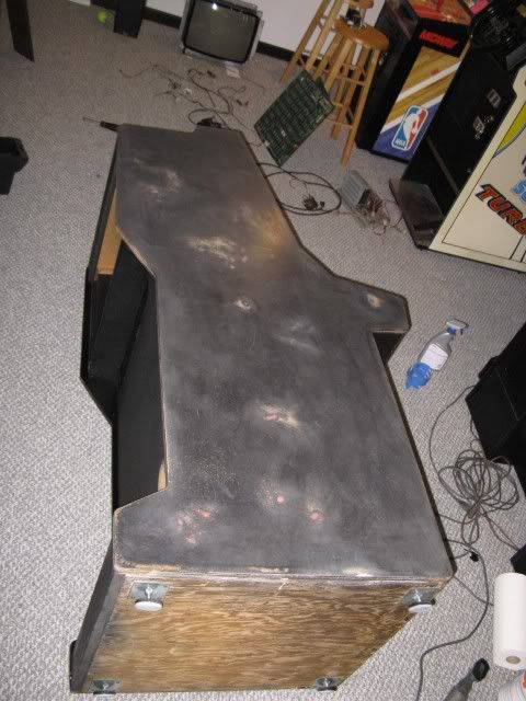

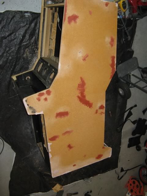

I went to work stripping off all of the existing vinyl, which came off quite easily…didn't even need to use heat:

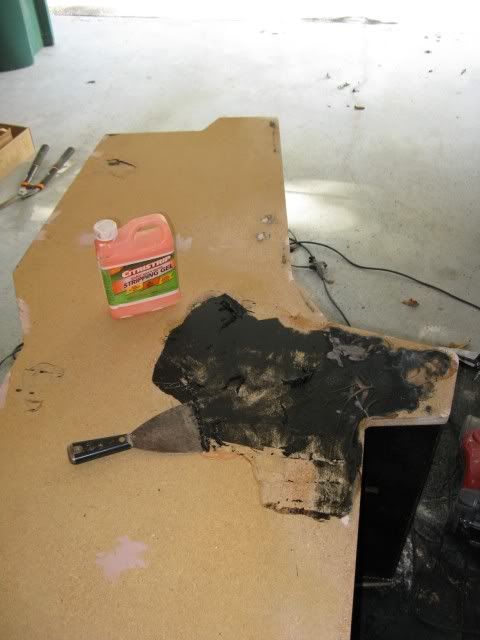

The black that's still there is paint. That's what I could see through the vinyl. I'm assuming that when this game was on route, someone tore the black vinyl and painted over it. Then, someone just vinyled over the paint and it left the lumps, bumps, and drips seen in the pre-restore pics. Nothing a little Citrustrip couldn't handle:

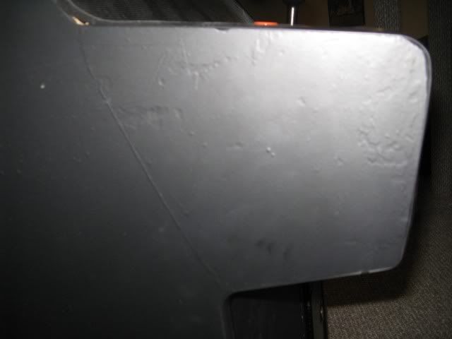

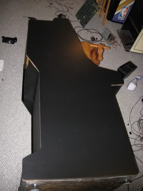

After that, it was on to everyone's favorite stage…Bondo! The edges were a little chipped and swollen, so I broke/sawed away all of those parts, used some wood hardener, and then repaired them. For small dents and dings, I've found that glazing putty works well. It's easier to use in thin areas and sands easily. So here's the aftermath:
The other side looked about the same. I primed it all with black automotive primer, which always brings out other small imperfections. This is where the glazing putty also works very well. Here we are after sanding the primer with 220 grit and fixing the small pits and dents:
Originally, I was going to try to save the vinyl on the front of the machine because it looked pretty good.

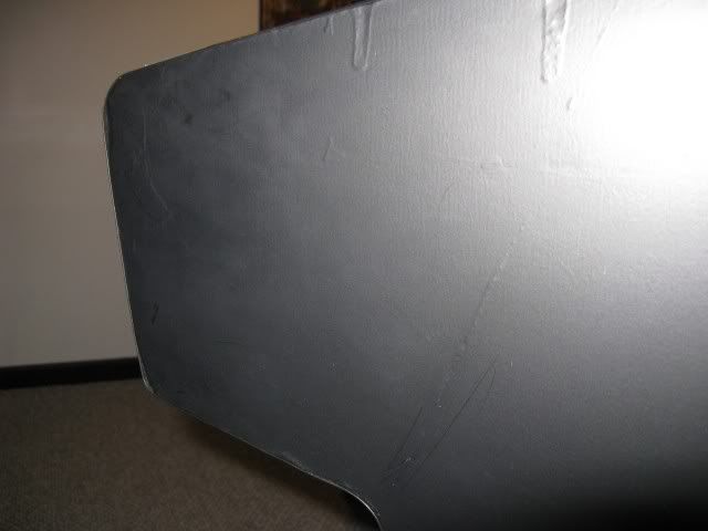

However, after messing around with it all, it got a little dinged, so I stripped that off:

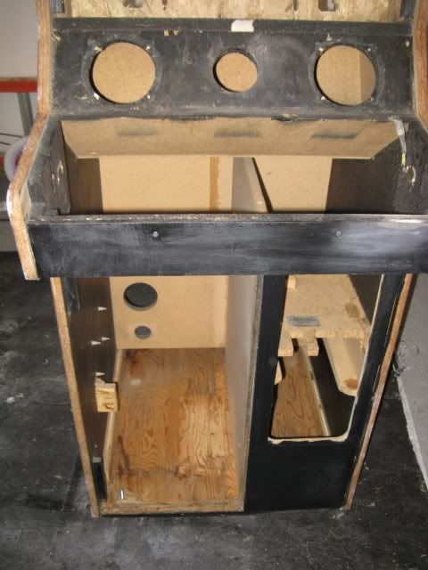

Look at that…this cab must've been a Roadblasters at one time in its life.

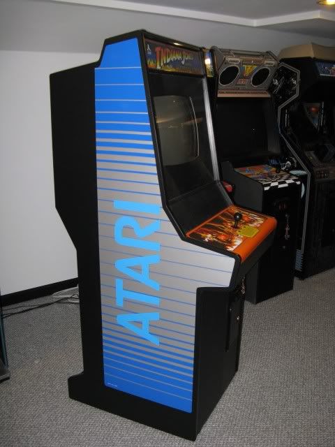

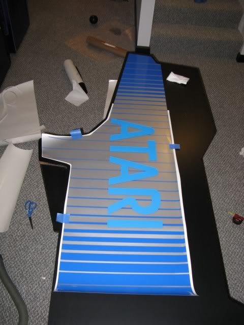

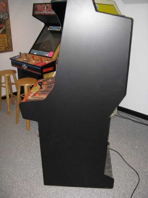

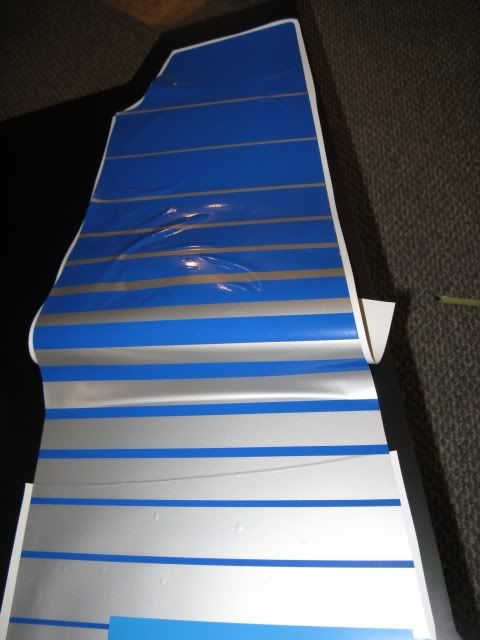

So now it was time for the System 1 side art installation. I really wanted to do a wet application, but I was out of Rapid Tac and couldn't find any near me and didn't want to order any. I had used it with the System 2 side art on Paperboy and it worked, but I really didn't see much benefit with large art. By the time I had it all wet, it was already starting to dry on one side and it made the application scarier than it needed to be. For smaller pieces, I think it's great, but I didn't like it for larger pieces. So, I went with my tried and true dry installation. It was a little tricky getting the spacing right, but it ended up fine:
Phoenix Arcade included a nice note stating that due to the paper backing, shipping, and the adhesive, that the art will look crinkly and separate from the backing:
Have no fear, with good, steady pressure and squeegeeing, it all comes out fine.

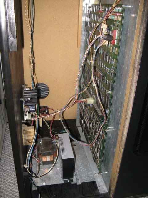

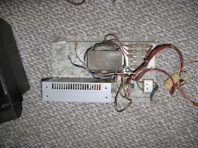

My power supply wasn't in too bad of shape:
I removed everything, gave it a good scrubbing and everything looked fine. In the past I've painted them, but there was only a few spots of corrosion that cleaned up with steel wool just fine, so I figured I'd just leave it original. I also cleaned up the isolation transformer, wires, fuse holder, etc. and re-installed them. I had previously removed and cleaned all of the other aluminum backing and painted the floor of the cab due to some staining that I couldn't sand out:

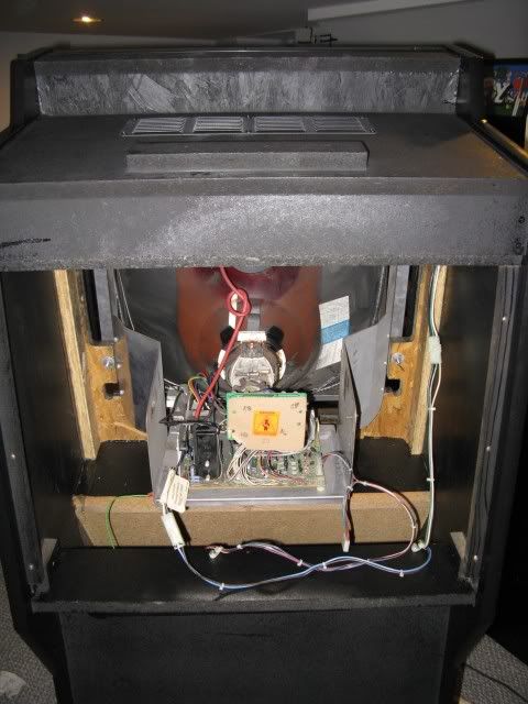

If you look closely, you'll notice that I don't have a fan in my game:
However, there also aren't any holes indicating that there was previously a fan…so I didn't install one. I figure that if this game has survived 27 years without one, it should be fine for 27 more.

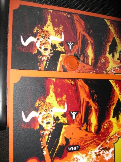

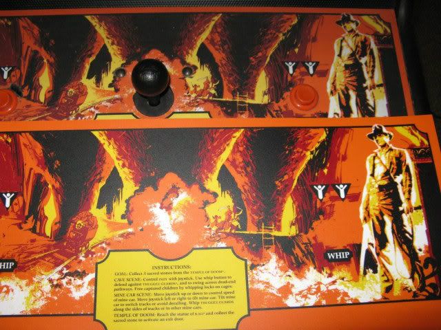

The next step was the CPO. Rich made a beautiful reproduction:
(Dumbass Photobucket keeps rotating this pic)
I did the typical heat gun to remove the old one, Goo Gone, and wire brush wheel in a plug in drill…battery powered ones poop out too easily. Installation hit a little snag when separating the backing from the CPO resulted in a pull of the art from the overlay. Rich came to the rescue with another one that went on without an issue. I used a little heat to make the bend and taped it down for a few days (not that you need to do that).

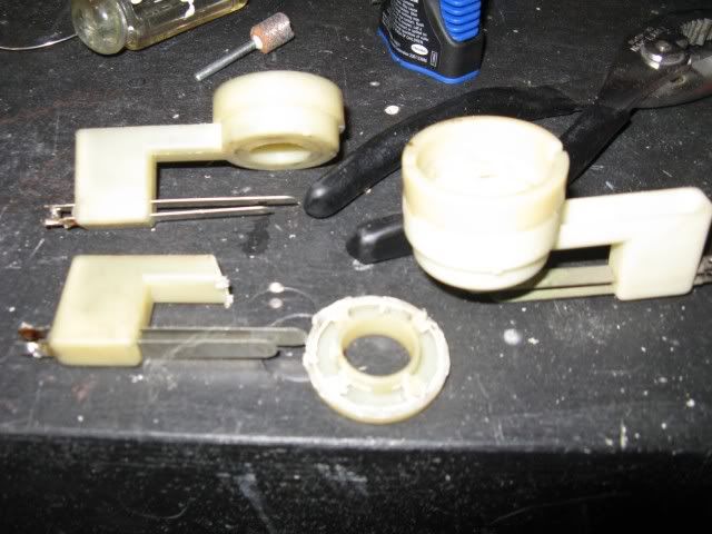

At one point in time, I tried to polish my dark orange buttons with some dental materials I had. They came out okay and were just shiny, but still a little dingy. I ended up finding out that Bob Roberts carries dark orange buttons, but they're longer ones than the original.
Unfortunately, I discovered this too late and didn't order leaf switches with spacers. So, I improvised and hacked up two old leaf switches that I had laying around to make new spacers:

And back into the line-up!

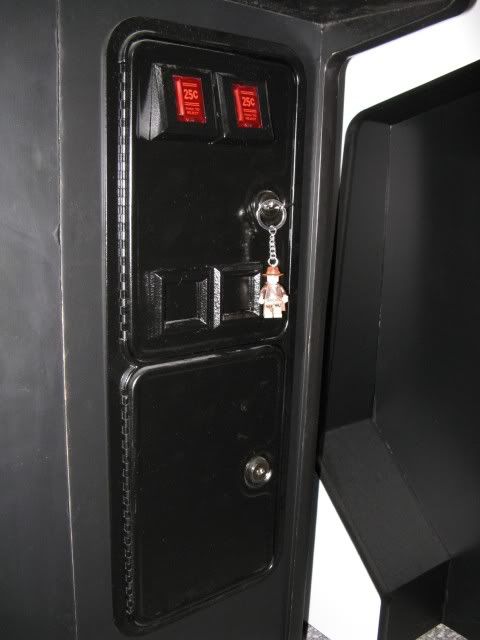

Love the Indy Lego key chain too!
Thanks guys. I always try to do something different for my key chains. SW has a Lego Darth Vader on it, ROTJ has a Lego Stormtrooper, Journey has a $5 casino chip with the Journey logo on it, both Trons have Prok's keychains, Pac Man has a little Pac Man I got from England, NBA Jam has a Seattle Supersonics keychain, Turbo has a metal Indy car on it I got from China, 720 has Tony Hawk and Steve Caballero mini-skateboard keychains...I just need to figure out something for Paperboy!
