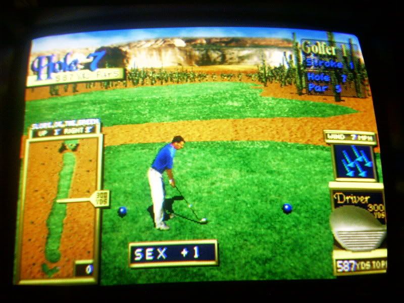

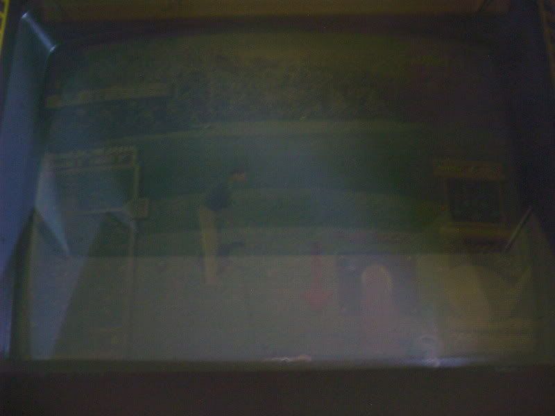

just wanted to show the video degradation on the GT2K board for you:
Plugged directly to Jamma harness:
Plugged into the switcher, with no video adjusting, just a straight swap:
Strangely, the GT2K board put out nearly perfect video when plugged into the jammaboard 2 in 1 switcher by itself, when the WCB wasn't plugged into the other edge connector.
Video splitting between 2 power hungry IT boards = the suck
Thats what my Lethal Enforcers looked like with LE2 on the second jamma connector before I added the relays. If they had designed this right they would have added the relays themselves, sure it would have only cost them a few bucks more a board.
