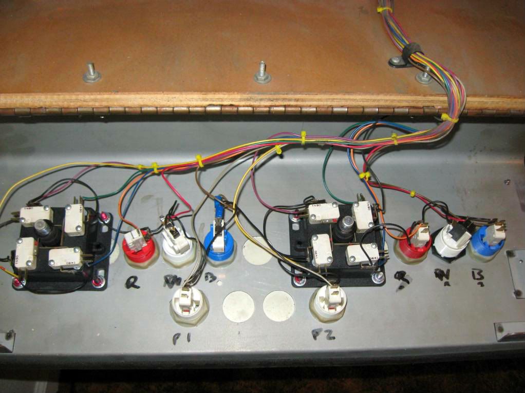

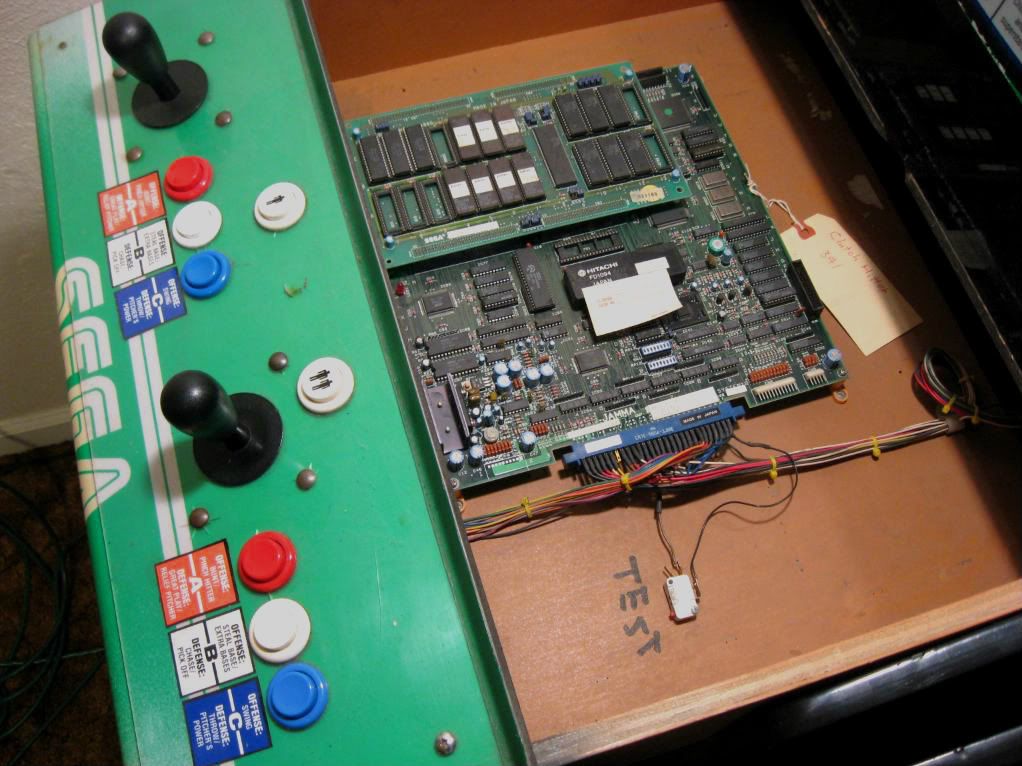

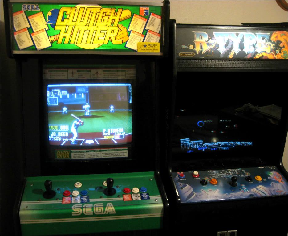

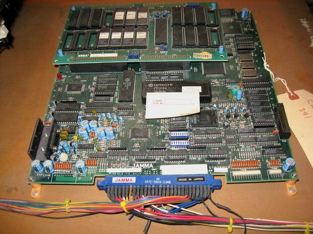

I have a Clutch Hitter cabinet. It's in good shape, everything works. The guy I bought it from showed me how to flip the yoke so I can switch it from horizontal to vertical.
Here are some pictures.

1- you have a JAMMA wired cabinet. nice and standard.
2- do you know if those controls are 4-way or 8-way?
Which means does the joystick do just 4 ways (N, S, E, W) or 8 ways( N, NE, E, SE, S, SW, W, NW)
The reason I ask about the controls is, Robotron, Bubbles, and Berzerk require 8 way controllers.
--If those games are important to you then the sticks are important.
--Most all other games use 4 way controllers.
--The problem is that playing 4 way games with 8 way controllers can sometimes cause eratic screen movements.
--joust and moon patrol, mario bros just need 2 way (left and right) so they work with any joystick, 4 or 8 way.

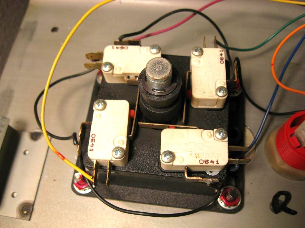

6-way. What I mean by that is Clutch Hitter uses 6-way moves. There's the four usual directions, then there's also SW and SE for throwing a screw ball or curve ball. There are no moves in the game requiring NE or NW. The instructions on the bezel show the six directional moves, but not those two. Can I assume since it can do those six directions that it's set up for all eight?
I don't know if this helps, but here's the underside of the control panel...

yes, your joysticks are capable of 8-way. (you have it setup but the baseball game is only using 6 of them as you say)
