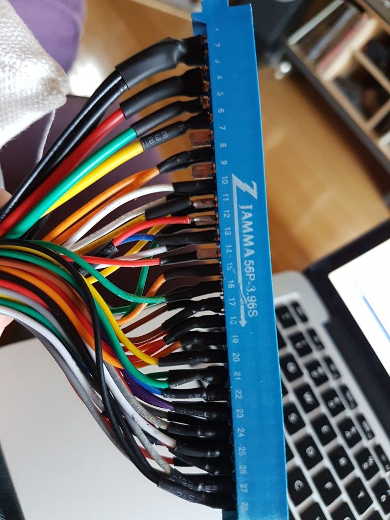

I saw that Canadian one and that it was chinese... I don't know if that's like 24 gauge wire or what, but I imagine a lot of people that report power problems are using those.
I haven't used it yet, but it's def made with 18AWG for all the power and ground and 22 for the rest. Seems pretty well put together. Though, I would't know what would constitute poor quality TBH.
Pic!
Are you sure that is 18 awg and not just a lot of insulation? Also, the limited number of wires on the power lines are usually a sign of lesser quality.
Looks like it doesn't really meet the Jamma standard and is really meant for the newer multi boards that aren't really Jamma.
Yeah, definitely 18 AWG! It's missing tilt, it seems.
