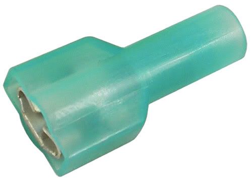

Wait, I believe I mis-read something. You have a complete JAMMA wiring harness, and you're looking to get something on the ends of the wires to connect them to the various switches in your cab?
Ah.....for that you just need insulated spade connectors, like this:
The above pictured tool MAY work for these. Most of them are just solderless crimp connections. Insert stripped wire, and crimp the collar of the connector nice and tight.
Bingo! :) Thanks for that but yes I need to put those connectors on and the part I wasn't sure of was what I needed to do to get them actually in and to stay.
