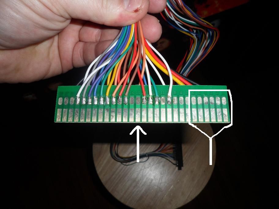

Hey guys. I know there are a lot of us here that use/need the Jamma extension harnesses and from what I can tell, they are all the same. I have purchased a few from all different suppliers and I always get the same ones. There are a few issues with them. They will not work for most games right out of the box because there is no video ground on pin 15 of the component side of the connector as well as the 5v, 12v, and grounds missing from the same side....

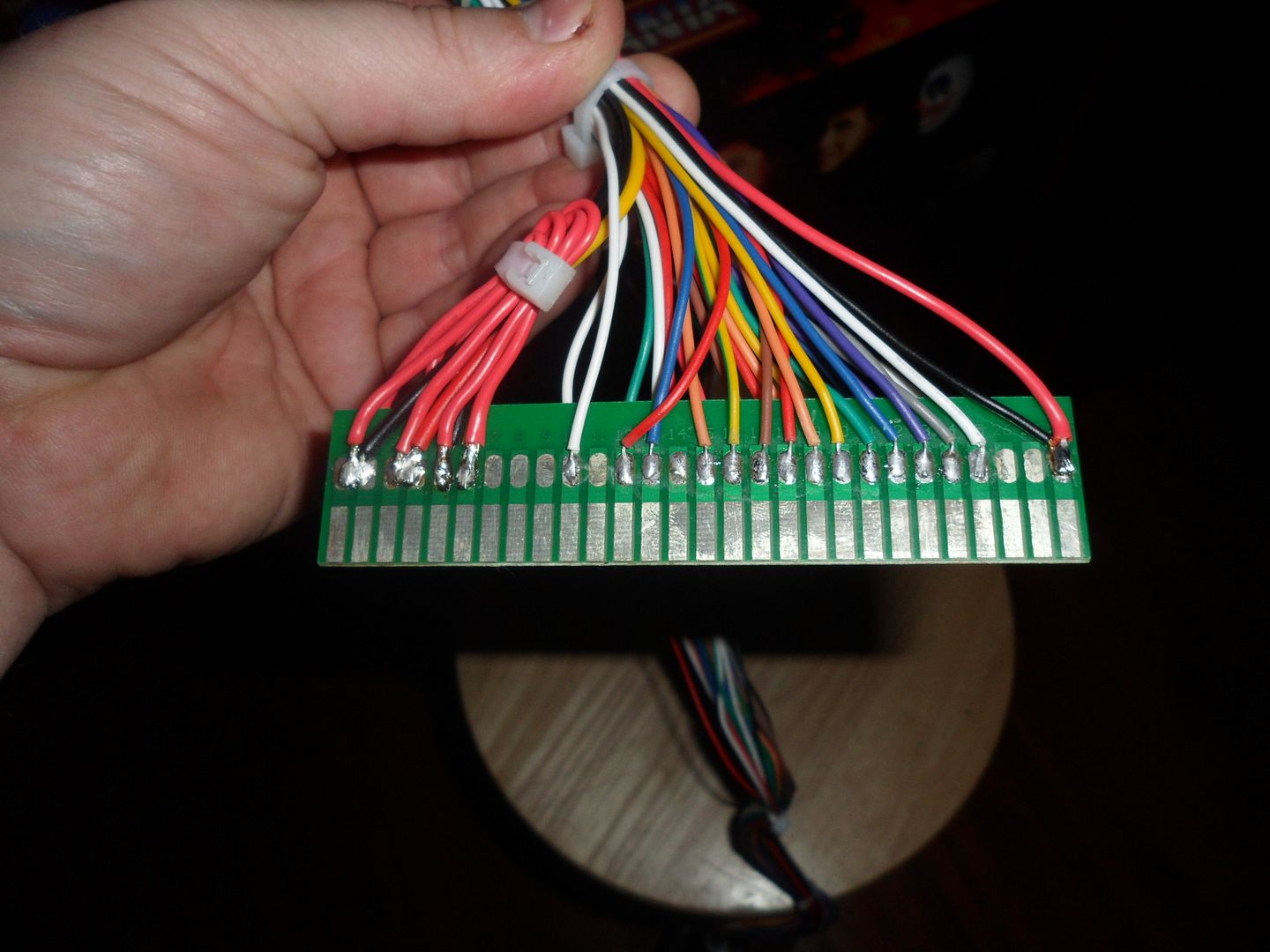

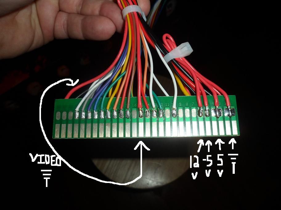

So you have to solder a wire onto the ground wire at pin 28 of the solder side and jumper it over to pin 15 of the component side to provide a ground for the video as well as jumpering the 5, 12, -5, and grounds from the solder side over to the component side because they are only on the solder side of the connector...

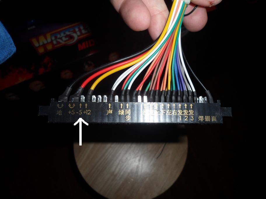

There's also no -5v. If you are going to use this extension harness for any of the 90's Midway fighters or any game that needs the -5v, you have to install a jumper from the Jamma connector to the edge connector at the appropriate locations...
Hope that makes sense because if you don't do thee mods, your board MIGHT work, but your colors will be wrong because of the missing video ground and your audio might not work because of the missing -5v. Let me know if you have any other questions and opinions are appreciated!

That is near the worst new harness I have seen. One wire for +5 and one for GND, wth?
I know your mod get's the harness working and the information you provided is very useful, but I wouldn't suggest doing it that way. You need to add a wire from the jamma plug to the PCB. One wire carrying all of +5 and GND will eventually result in something getting burnt. You might get away with it on the low powered multi boards.
Makes sense and you are probably right. The mods I did and describe will at least get the person going as they are pretty much useless when you get them. That's a good point.

great writeup, but jamma spec says video ground is on pin 14
Thanks. Yes, but the grounds are technically all the same. As long as the video ground is going to a ground, whether it's on pin 14 or not, it will still work. I know you are saying that the video ground is supposed to be on pin 14, but it will still function as advertised as long as it's grounded.
