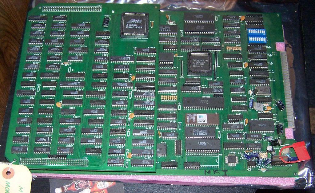

So I bought a large stash of Mortal Kombat boards and finally got them today. Inside I found a board labeled Mortal Kombat 1 on a tag and MK1 written in black marker on the PCB but i know for a fact that this is untrue!!
It's a non-jamma board so i really don't have any way of testing it.
so here it is!

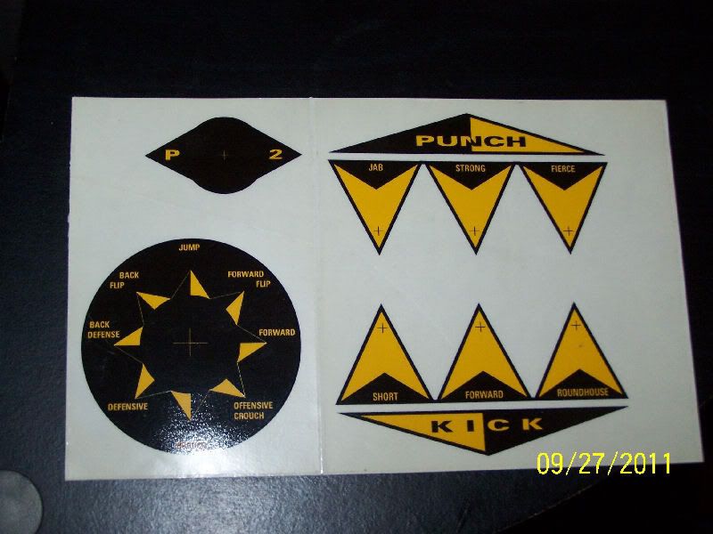

Name that Control Panel Sticker!!!
Mortal Kombat (boot?)
SFII Stickers
What do I win?
it's not mortal kombat lol

edit: if that's street fighter which one is it (the sticker)??? i looked through the 50 or so different versions in the database and didn't see a CP that looked like it had these stickers (i also never noticed the kicks were labeled "short,forward, roundhouse"
The board is probably some sort of Sega System 16B board, maybe?
(Actually, I just looked at 16B photos... Probably not.)
Did you try plugging the board in? Looks like it probably is jamma, and I would bet that it probably is a MK1 bootleg considering a few of those chips and that it came with a bunch of other MK pcbs.

The stickers:
http://www.videogameparts.com/product.sc?productId=848
I have a set of them.
As for the PCB, just used the markings on it, lol
weird, and thanks! i'd rep you but i did recently already :(
haven't attempted to power it up yet and won't as i'm pretty sure it's not a jamma board, also it doesn't have header pins for the kick harness so doubtful it's a bootleg (never seen a bootleg before personally either cept the ones with rom hacks).
How are you so sure it is not a Mortal Kombat bootleg board if you can't test it?
Heres a photo of a confirmed MK bootleg - looks strikingly similar!
http://www.arcadegame.cz/vlastnim/pcb/arcade_pcb_mortal_kombat.jpg
It looks JAMMA to me, boards of this era almost always were.

This post: http://classicmk.com/index.php?topic=1743.msg42449#msg42449
Shows the same PCB as yours in the google image cache but the original is no longer on Flickr.

There are a number of unused pins in the JAMMA standard on the connector at the other end from the power pins. These were blank on a true JAMMA harness but are often labelled as NeoGeo on labels as SNK used them for extra buttons on the NG platform. It is possible that the bootleggers did the same and the normally header supported buttons are connected there negating the need for the header.

I'm hesitant to power this guy up as there looks to be a resistor network (thanks womble) soldered in where the 2 boards mate on one side, however it's not in the one that womble linked.
womble's link: http://www.arcadegame.cz/vlastnim/pcb/arcade_pcb_mortal_kombat.jpg
i guess there's a few other dis-similarities between the two so maybe that's suppose to be there on mine, but it does seem damaged. guess i just need to put on my big boy pants and suck it up (tomorrow...).
Let my curiosity get the best of me today, pulled the key from my edge connector. game works great, plays perfect, i get a custom chip error in the board test but i figure that's just because it's bootleg. Played a few games and bagged/boxed it back up lol, key's back in my edge connector where it belongs.

Here's a pic (excuse my shaky hand, had to hold the test button down in my spider-man cab to keep it in test). it's just 3.0 so nothing special but still very neat!
I had that same bootleg and sent it to the mame team. It is based off 3.0 but some sounds are different and the character sprites are larger than a normal 3.0.
