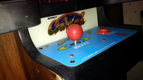

it's original should i replace this?

I'd suggest:
- Mask off clear parts,
- Apply triple thick clear pottery glaze,
- Apply Saran Wrap over to hold down the flaky parts during drying,
- Once dry touch up as needed and probably spot coat with more triple thick,
- If the coats came out thick or uneven, smooth off the highspots with 1000-2000 wet sanding.
I'm not sure how much original affects value on these. But if the original is in poor condition, it'd probably be worth about the same whether you touch it up or replace it.
All this.. and to sum it up. At least try to save it is what "sir spiffs alot" is sayin.
Try to touch the original stuff up as much as you can.
see how it looks after.
Rock it like that for a while , if you get gagged on too much or feel unsatisfied .
then take the steps to find a NOS or replacement.
I have underlay on mine with new glass. I like it. (though if you have the $$, a nice new silk'd glass would be better)
I also have these -> :D (lucky to have too)
