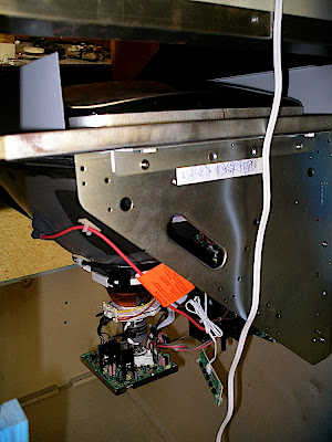

Turned on the power for the first time yesterday, only to have my d9500 not sync, a few minutes of goggling and I find mod's post about this monitor using composite sync, quick change of the sync pin and I have video.

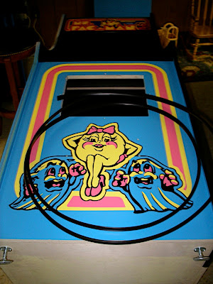

Finally some pic's

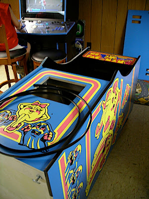

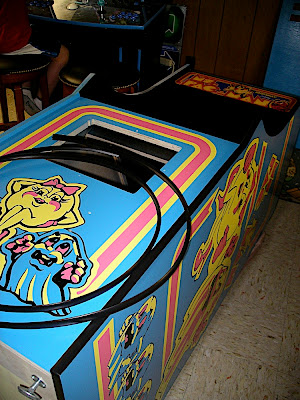

Here is the cab when I first got her, let the whistling begin......

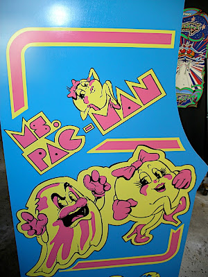

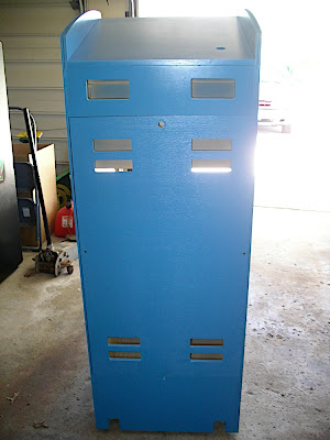

Just wanted to say that the work Bret did on this cab was simply amazing!
Fit and finish is top notch, Everything fits perfect without any modification or trouble at all. Jpopson's paint job is top notch as well, my only comment is that the black on the inside of the cab is a little thin, but the sides (where it counts) of the cab are absolutely gorgeous!

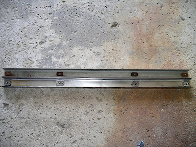

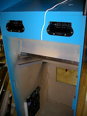

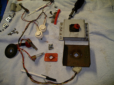

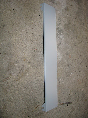

Some bracket work before and after shots
Everything cleaned up nicely with a wire wheel on the drill, painted before I installed to prevent any future rusting

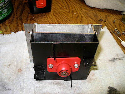

Completely rebuilt the joystick
A little rusty before
After a good soaking and cleaning / fresh paint
New grommet from TRBR now she is nice and tight again, I really hate sloppy or loose women

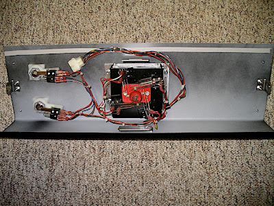

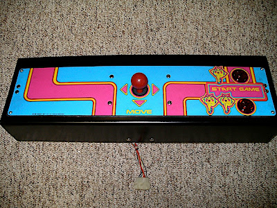

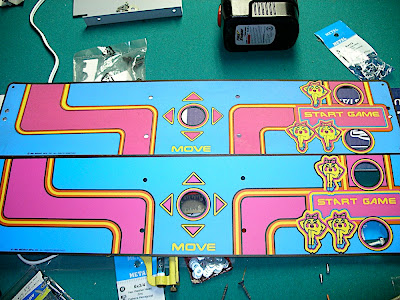

Now on to the control panel
This turned out to be the biggest PITA job of this entire build but persistance pays off
See the difference from origional to repro!
I went with the good stuff,
thanks to Brian (Pr0k) again for the new backer for the overlay, worked great!

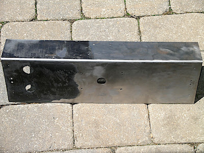

2 coats of primer and 4 coats of satin black makes it look like new.

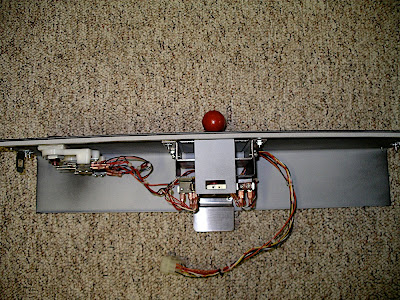

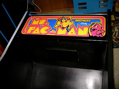

Went with some lighted buttons for player one and 2, I repinned the cp harness as the cab is wired jamma. I also added a few pins for the 12volt power and ground and player 1 button 1 and 2. All on the 12 pin molex to keep it a one connection break, this also keeps the inside nice and tidy.
Here it is finally done

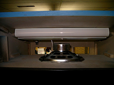

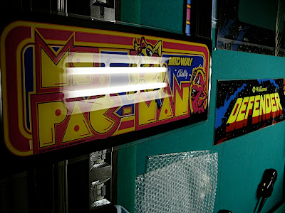

6.00 dollar light from Lowes , a new speaker and grill

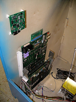

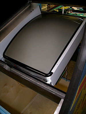

Brand new D9500 test fit
An original pac with the evar so awesome 96 in 1 kit and an AS programmable multiboard
T-molding going on
