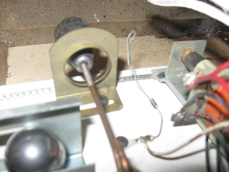

I also noticed something I had not seen before on the MPU. I found a small wire that had been soldered from the 1st pin of the 4 pin connector (on the top left) to the 1st pin on the other 4 pin connector on the top next to it. Why the hell would someone have done that anyway?
To sum things up, the coin door diagnostic buttons now work. Eject hole and playfield tilt now work (bottom row switches).
Still no tilt switches 1 & 2. Any idea where this diode is supposed to go? Found it today (sorry about the pic quality)

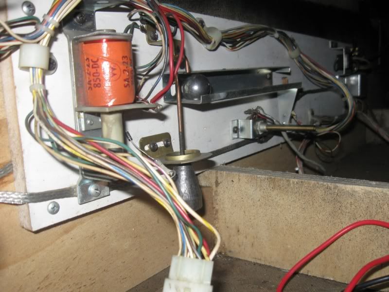

I can now get into the switch diagnostic, and I have some weird stuff going on with one switch activating another, etc. I don't know if maybe some switch is getting stuck closed sometimes or what.
That loose hanging diode probably went to the plumb-bob tilt. There should be a wire connected to the ring portion of the plumb-bob tilt, and I think that this was their way of disconnecting it.

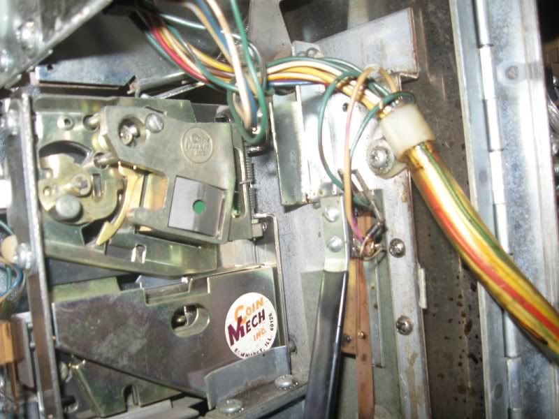

I bet you'll find more oddball stuff going on in the wiring if you start looking closely. How about shooting a photo of the coin door wiring, as my bet is that you'll find something odd there. On my Black Knight I found that somebody had jumpered the start button to a coin switch, in order to set up free play. I guess they didn't know you could just turn that feature on via the diagnostic switches.

The switches look fine, it's just that it's missing the yellow switch covers for two of them, which is pretty typical. But I don't see any wiring that's out of place.

There is one more cover sitting inside the cab I have to get around to putting on. The game only came with two though, not all three.
I looked at my other game and realized that disconnected diode around the plumb bob tilt needed to go around one of the screws. I reconnected it, and now the roll tilt and plumb tilt work. I guess I'll just have to see over time if there was some reason why that was disconnected (tilting when it wasn't supposed to?) or if it was just another odd "repair" choice.
