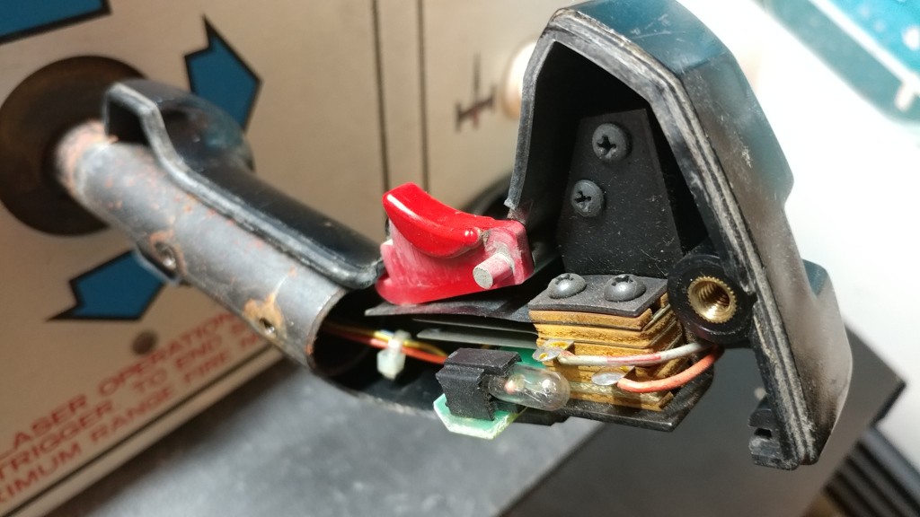

Thought I saw these for sale a while back. The 2 inch black and red plastic on front. Thx
Are you talking about the red and black insert? If so groovy game gear has the original color and custom colors for $4.95 each. You can get brand new handles and trigger from happ.

Beat me to it. You can order each part separate too.

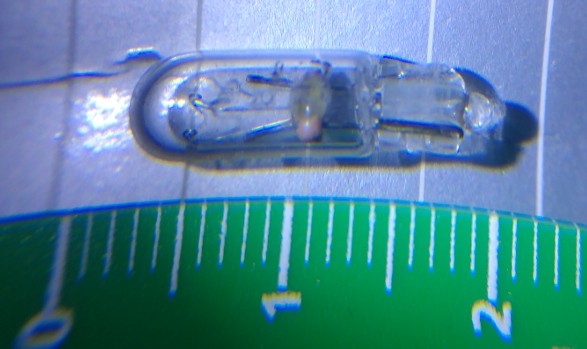

How about the bulbs that light it up?
It's an #E74 mini wedge bulb (T1-1/2 = 3/16 = 4.76mm base), rated @ 0.08amp 14vdc
http://www.bulbtown.com/E73_MINIATURE_BULB_GLASS_WEDGE_BASE_p/e73.htm
